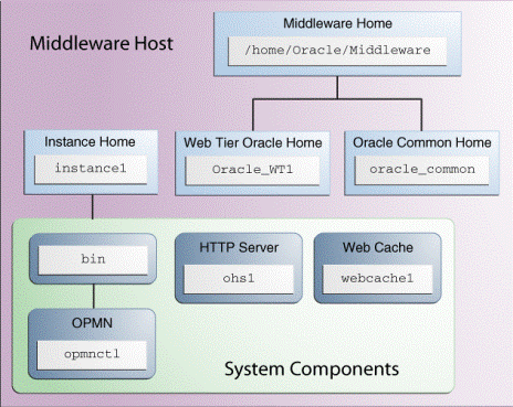

This guide contains instructions for installing and configuring Oracle Web Tier on a single host in a stand-alone mode (the components will not be associated with a WebLogic domain). Figure 1 illustrates the topology that will be created on your system at the conclusion of this procedure.
Figure 1 Oracle Web Tier Stand-Alone Installation Topology
Note that although Oracle WebLogic Server is not required to complete an Oracle Web Tier installation, the directory structure for the Middleware home must still be present. This is to make the directory structure for Oracle Web Tier consistent with other Oracle Fusion Middleware products, all of which require the existence of WebLogic Server and its corresponding directory structure.
In the case of an Oracle Web Tier installation in a stand-alone mode, the directory structure will still be created despite the absence of Oracle WebLogic Server.
