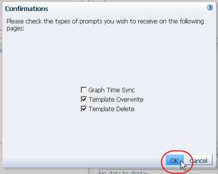

Use this procedure to customize the display of selected confirmation dialog boxes for your username in this and future login sessions. See “Confirmation Dialog Box Options” for details.
1.
Select Preferences > Confirmations from the Main Toolbar.
The Confirmations dialog box appears.
2.
Graph Time Sync – Selecting this check box indicates you want a confirmation dialog box to appear before you synchronize all graphs on a screen to the same date range.
Deselecting this check box indicates you want to suppress the confirmation dialog box. Graphs will be synchronized as soon as you click Synchronize Date Range in the Graph Pane Toolbar.
Template Overwrite – Selecting this check box indicates you want a confirmation dialog box to appear before you save changes to an existing template.
Clearing this box indicates you want to suppress the confirmation dialog box. Existing templates will be overwritten as soon as you click Save in the Save Template dialog box.
Template Delete – Selecting this check box indicates you want a confirmation dialog box to appear before you delete an existing template.
Clearing this box indicates you want to suppress the confirmation dialog box. Templates will be deleted as soon as you click Delete in the Delete Template dialog box.
3.
The settings take effect immediately. They remain in effect for future login sessions, until you change them again using this procedure.
