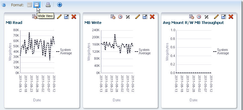

Use this procedure to display graphs in narrow and wide formats. Narrow view is the default, and it allows you to do side-by-side comparisons of graphed attributes. Wide view allows you to see each graph in greater detail.
1.
The display changes to wide view, in which each graph pane is expanded horizontally across the entire Graphics Area. A vertical scrollbar appears, allowing you to scroll down to the remaining panes.
