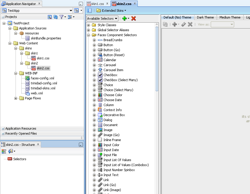

If you accepted the default value proposed for the Directory field, a file with the extension .css
is generated in a subdirectory of the skins
directory in your project. This file is opened in the visual editor for the ADF skin, as illustrated in Figure 4-1.
The trinidad-skins.xml
file is modified to include metadata for the ADF skin that you create, as illustrated in Example 4-1.

The first time that you create an ADF skin in your project, a resource bundle file (skinBundle.properties
) is generated, as illustrated in Figure 4-1. For more information about using resource bundles, see Chapter 7, "Working With Text in an ADF Skin."

The ADF skin(s) that you import from the JAR file appear in the Extends list when you create a new ADF skin, as described in Section 4.4, "Creating an ADF Skin File." After you create a new ADF skin by extending an ADF skin that you imported from a JAR file, the Extended Skins list in the Preview Pane displays the name of the ADF skin that you imported. For example, in Figure 4-2 the skin2.css
ADF skin has been created by extending the ADF skin, jarredskin.css
, that was imported into the project from a JAR file.
Properties that have been defined in the ADF skin that you imported appear with a blue upward pointing arrow in the Property Inspector. An information tip about the inheritance relationship displays when you hover the mouse over the property, as illustrated in Figure 4-3.
