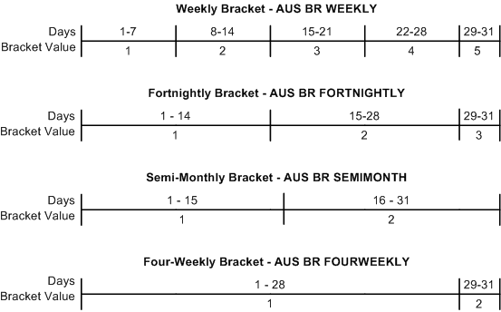

Weekly, fortnightly, semimonthly, and four-weekly brackets return values depending on where the pay period end date occurs, as the following diagram shows:
Bracket values for each period
To provide examples, the following table shows the bracket value that each bracket returns for day 5 and day 27 of the month:
Bracket
Value for Day 5
Value for Day 27
Weekly
1
4
Fortnightly
1
2
Semimonthly
1
2
Four-weekly
1
1
The formula uses the bracket values, which indicate to the system whether the pay period end date is in the relevant period. The formula checks the bracket that corresponds to the frequency type.
For the period 1 formula for example:
If AUS VR FREQ TYPE = 'W' (weekly) Then If AUS BR WEEKLY = 1 Then...TRUE If AUS VR FREQ TYPE = 'B' (biweekly or fortnightly)Then If AUS BR FORTNIGHLY = 1 Then...TRUE
The formula returns True when the pay period end date is in the bracket value that corresponds to the period. That is, for period 2 when the bracket for a frequency type returns 2, the formula returns True.
For example, to have the earning paid in the first period, you attach the period 1 generation control to the earnings element. If generation control formula for period 1 returns the bracket value 1, the formula returns True—regardless of the frequency specified in variable AUS VR FREQ TYPE, .
