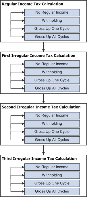

Understanding the Overall Flow of Tax Calculations
The following graphic describes the overall flow of tax calculations in Global Payroll for Thailand:
The Global Payroll for Thailand process list has four sections for tax calculation:
Regular Income Tax Calculation.
This section calculates the personal income tax for regular income. Based on the current payee's type of regular income, this section chooses the tax calculation type to calculate the regular tax.
First Irregular Income Tax Calculation.
A payee can have three different types of irregular income within one payroll period: withholding, gross up all cycles and gross up one cycle. There are three separate sections to calculate different types of irregular incomes. Based on the configuration, this section can calculate withholding, gross up all cycles, and gross up one cycle irregular income taxes. If the organization specifies that this section calculates withholding tax, but the current payee does not have any withholding irregular income, then this section is skipped.
Second Irregular Income Tax Calculation.
You can specify the tax calculation type for this section.
Third Irregular Income Tax Calculation.

Setting Up Irregular Income Tax Calculations
Global Payroll for Thailand provides several formulas that enable you to determine the calculation order of the three types of irregular income: withholding, gross up one cycle, and gross up all cycles. The formulas are:
TAX FM IR FACTOR1
This formula enables you to specify which type of irregular income tax is calculated first by assigning different values to the TAX VR CAL METHOD variable. You must use specific abbreviations for each of the different types of irregular income, as follows:
WH is used to indicate the withholding irregular income tax calculation type.
GA is used to indicate gross up all cycles irregular income tax calculation type.
GO is used to indicate gross up one cycle irregular income tax calculation type.
Adding your own if-else clauses into this formula enables multiple groups of employees to use different initial tax calculation types.
TAX FM IR FACTOR2
This formula enables you to specify which type of irregular income tax calculation type is calculated second.
TAX FM IR FACTOR3
This formula enables you to specify which type of irregular income tax calculation type is calculated last.
Warning! Incorrectly configuring these three formulas can cause errors in the calculation of irregular income taxes. For example, if all three formulas contain the code:'WH' >> TAX VR CAL METHOD, then the withholding irregular tax is calculated three times, while the other types of irregular taxes are not calculated at all.

So employees in Pay Group A use the gross up all cycles tax calculation type first, while employees in Pay Group B use the gross up one cycle type first, and employees in Pay Group C use the withholding tax calculation type first.
In order to accommodate this combination of tax calculation sequences, modify the three calculation order formulas as shown in the following table:
Contents of TAX FM IR FACTOR1 |
Contents of TAX FM IR FACTOR2 |
Contents of TAX FM IR FACTOR3 |
