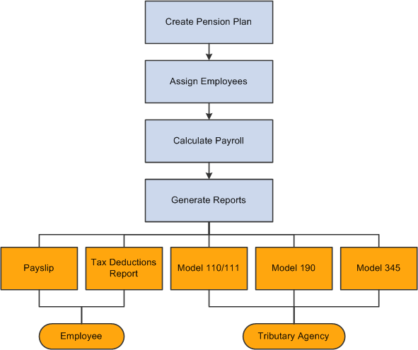

This diagram illustrates the business process flow for pension plans from creating the pension plan, assigning employees, and calculating payroll to generating payslips and reports:
Business process flow pension plans in PeopleSoft Global Payroll for Spain

Steps to Manage Pension Plans
To manage pension plans:
Create and maintain pension plan definitions using the Pension Plan page.
Assign employees to pension plans and maintain data using the Payee Pension Plan ESP page.
Calculate payroll for employees with pension plans.
Generate regular reports, which include information related to pension plans.
Generate the Model 345 file using the Create 345 Model File ESP page.
