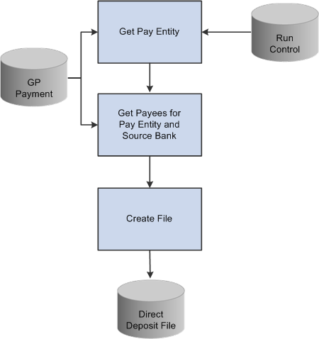

Generating the EFT Payment File
This section provides an overview of the Payment EFT File Creation process and discusses how to create the Payment EFT File.
Understanding the Payment EFT File Creation Process
You use the Create Payment EFT page to define the parameters for the EFT file and to run the Create Payment EFT File process.
This diagram shows the Create Payment EFT File process:
