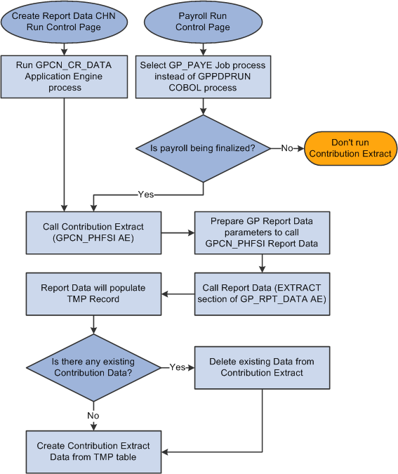

The system extracts data for these reports during payroll finalization using the Report Data feature. It produces the reports in both PDF and CSV file formats.
Process Flow
This diagram illustrates the flow of the PHF/SI report data extract process:
PHF/SI report data extract process flow

Creating PHF/SI Report DataAccess the Create Reporting Data CHN page (Global Payroll & Absence Mgmt, Authority Correspondence, Create Reporting Data CHN). Use this page to run the Create Reporting Data CHN (GPCN_CR_DATA) Application Engine process. This process calls the GPCN_PHFSI Application Engine process, which generates Public Housing Fund and Social Insurance (PHF/SI) report data for the selected calendar group.
The Create Reporting Data CHN (GPCN_CR_DATA) Application Engine process simultaneously calls the GPCN_TAX Application Engine process, which generates tax report data for the selected calendar group.
Note. Instead of manually running the GPCN_CR_DATA process from this page to generate report data, you can select the GP_PAYE Job process instead of the GPPDPRUN COBOL process when you finalize a calendar group. This is similar to the way that GPCN_CR_DATA, GP_PAYE calls both GPCN_TAX and GPCN_PHFSI.
