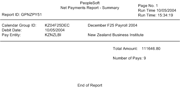

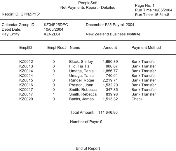

Click to jump to parent topicReporting Net Payment
The Net Payment Report GPNZPY51 is a listing of all the net payments generated by the core Global Payroll banking process. You enter the calendar group ID you want to report on and specify if you want payee level detail or just a summary.
Net Payment Detail report
Net Payment Summary report
