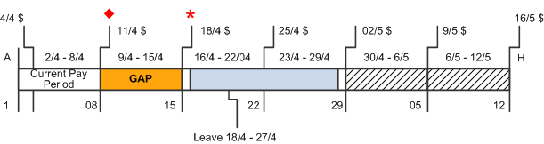

A pay period preceding an absence that is paid after the start of the absence. |

The following two diagrams show the On Return and Normal Cycle gap options in effect. For both scenarios, the First Period and Last Period options are both Advance Whole Period. The diamond marks the advanced leave payment date and the asterisk marks the gap pay date.
In this diagram, the gap is paid on return. Therefore, the payment occurs on the first payment date after the return from leave.
Gap on return
Payment Schedule |
16/4 - 17/4 Regular |
Pay Period Ending 08/4 (so paid 11/4) |
18/4 - 27/4 Leave |
28/4 - 29/4 Regular |
09/4 - 15/4 Gap |
Pay Period Ending 15/04 (so paid 02/5) |
In this diagram, the gap is paid in the normal cycle. Therefore, the payment occurs on the regular payment date for the gap period, even though the employee is on leave.
Gap in normal cycle
Payment Schedule |
18/4 - 27/4 Leave |
09/4 - 15/4 Gap |
Pay Period Ending 29/04 (so paid 18/4) |
