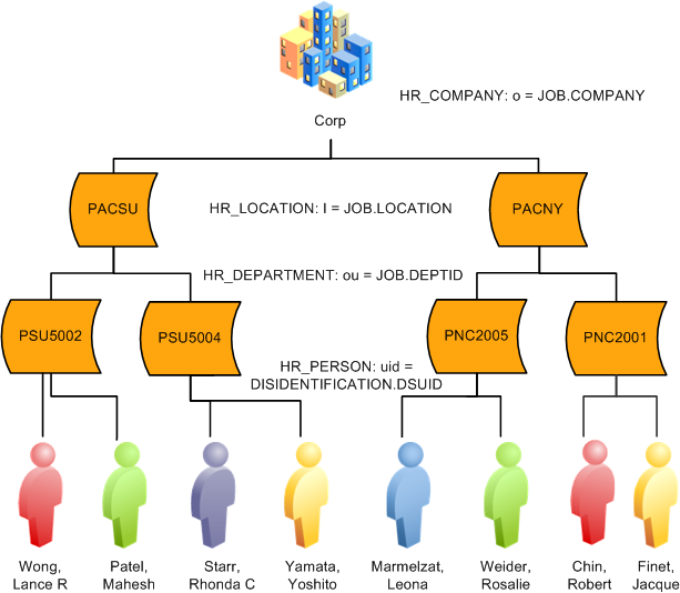

Click to jump to top of pageClick to jump to parent topicUsing Sample Mappings
To use sample mappings that PeopleSoft delivers, establish directory IDs in the Directory Configurations component (PSDSSETUP) and add a directory ID to the mappings. The sample mappings use schema objects from a standard Novell eDirectory.
We developed the sample mappings assuming that you are using the tree structure illustrated below, which is HR_PERSONs reporting to HR_DEPARTMENT, the departments are associated to the HR_LOCATION, which report to the corporate level, or HR_COMPANY:
Sample Directory Interface tree
Note. PeopleSoft delivers HR_LOCATION, HR_DEPARTMENT, and HR_PERSON as sample mappings
