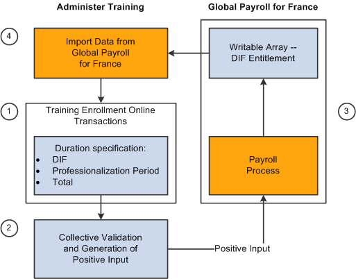

Use the Demand from Budget Training and Training Hours Details pages to:
Indicate when enrollment in a course occurs as part of a professionalization contract.
Indicate when enrollment in a course occurs for the purpose of skills development.
Record DIF and non-DIF hours.
Validate DIF and skills development training hours and transfer these hours to the payroll system using the FRA Training Validation (GP) and FRA Training Validation (TRN) components.
Process payroll and calculate DIF and skills development entitlements (earnings) in Global Payroll for France based on the training hours validated in step 2.
Import DIF balance data from Global Payroll for France into Administer Training using the writable array FOR WA DIF HR.
Training administrators and others can then view this data on the enrollment pages in Administer Training to determine whether there are enough hours in a student's DIF balance to permit additional DIF allocations.
These four steps can be represented as follows:
Diagram of the four steps for tracking and processing training data

Importing Payroll Data Into Administer TrainingThis section provides an overview of the data import process and discusses the page used to import payroll data into Administer Training from Global Payroll for France.
Understanding the Data Import ProcessWhen you run the Global Payroll process, the system calculates both the DIF entitlement balance (FOR AC DROIT DIF) and DIF in advance hours (FOR VR DIF NEGATIF) for all trainees and loads this data into a table using the writable array FOR WA DIF HR. When you run the import process on the DIF Payroll Import page, the system imports the entitlement balance and DIF in advance from this table into Administer Training. You can then view this information on the enrollment pages and determine whether there are enough hours in a student's DIF balance to permit additional DIF allocations.
Note. The element FOR AC DROIT DIF stores the DIF entitlement balance and is calculated as the trainee's DIF allocation minus the DIF hours already used. The element FOR VR DIF NEGATIF stores the number of hours of additional DIF training (DIF in advance) that can be granted beyond what is available in the DIF balance. When you run the import process, the value of these elements appears on the Training Hours Details page.

Importing Data
Access the DIF Payroll Import FRApage (Enterprise Learning, Result Tracking, DIF Payroll Import FRA, DIF Payroll Import FRA).
Period Begin and End Date |
Enter the dates of the payroll period for which you want to retrieve data. |
Pay Group |
Specify the pay group for which you want to retrieve the DIF data. |
Run |
Click to initiate the import process. |
