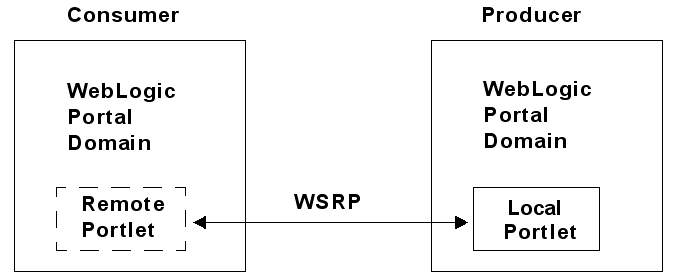

Figure 4-1 illustrates the basic parts of a federated portal, where the consumer includes a remote portlet. A remote portlet is a proxy for a portlet that is deployed in a producer application.
Tip:
To an end user, the features of the remote portlet are indistinguishable from the actual portlet deployed on the producer. It is possible, however, to customize many of the properties of a proxy portlet, as explained in Chapter 5, "Configuring Remote Portlets."

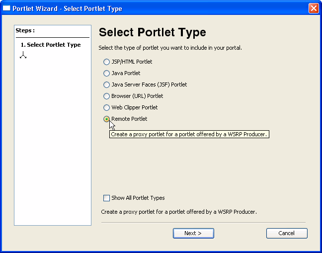

In the Select Portlet Type dialog, select Remote Portlet, as shown in Figure 4-3, and click Next. The Portlet Wizard – Producer dialog box appears.

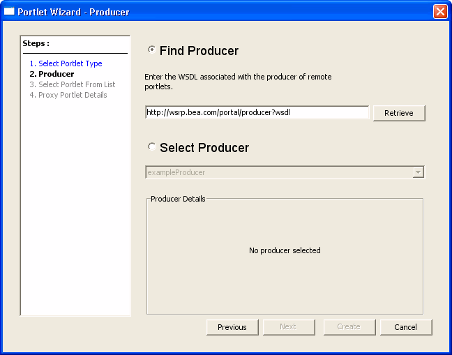

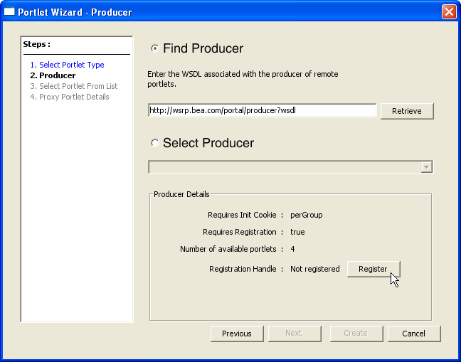

In the Portlet Wizard – Producer dialog, select Find Producer and, in the field provided, enter a WSDL URL. For example:
http://wsrp.bea.com/portal/producer?wsdl
Just remember that the pattern for the URL is as follows:
http://
host
port
webAppName
/producer?wsdl
where host is the host
and port
are the hostname and port number of the server on which the producer is deployed, and webAppName
is the name of the web application in which the producer's portlets are deployed.
Tip:
If the producer was previously added to the consumer, it will appear in the Select Producer list, and you can simply choose Select Producer and select the producer from the list.
Tip:
WSDL stands for Web Services Description Language and is used to describe the services offered by a producer. For more information, see Chapter 3, "Federated Portal Architecture."
After entering the WSDL URL, click Retrieve.

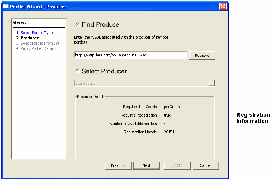

Checkpoint: At this point, the consumer uses the WSDL to locate the producer and learn about its available portlets. The Producer Details section of the wizard panel now displays information about the producer, including the number of portlets that are available to the consumer, as shown in Figure 4-5.
Click Register in the Producer Details section of the wizard panel, as shown in Figure 4-5. The Register dialog appears.
Tip:
During registration, the producer stores information about the consumer and returns a handle to the consumer. Registration is an optional feature described in the WSRP specification. A WebLogic Portal complex producer implements this option and, therefore, requires consumers to register before discovering and interacting with portlets offered by the producer. See Section 3.4.2.2, "Complex Producers" for more information.

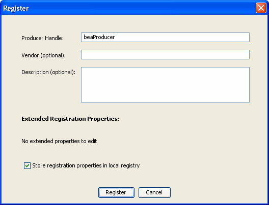

In the Register dialog, enter beaProducer
in the Producer Handle field, as shown in Figure 4-6. This handle identifies the producer on the consumer. This dialog also lets you choose to store registration properties on the consumer and (if available) edit the registration properties Registration properties are values that are passed from the consumer to the producer when the producer is registered. These values can be used to allow producers to control which portlets are offered to specific consumers. For detailed information storing registration properties, see Chapter 14, "Other Topics and Best Practices."
Click Register. You are returned to the Producer dialog.
Checkpoint: At this point the WSDL data from the producer has been retrieved and is displayed in the Producer Details panel of the dialog, as shown in Figure 4-7. Note that four portlets on the producer are available to the consumer.

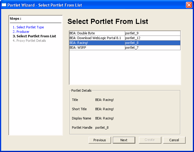

In the Select Portlet from List dialog, select one of the remote portlets from the list of portlets on the producer, as shown in Figure 4-8. You can pick any one of them.
Figure 4-8 Select a Portlet on the Producer

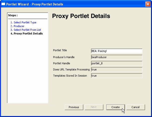

Click Next. The Proxy Portlet Details dialog appears. The title of the portlet you selected appears in the Portlet Title field, as shown in Figure 4-9. You can change this title if you want to.
If the producer does not require registration, the Producer's Handle field will appear editable and initialized. In this case, you must enter an arbitrary value for the producer handle before the Create button will be enabled.
Click Create.

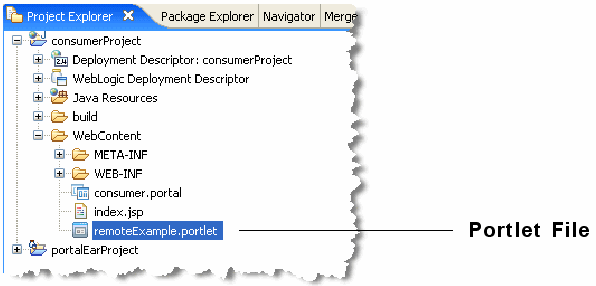

The new remote portlet shows up in the Project Explorer in the WebContent folder, as shown in Figure 4-10.

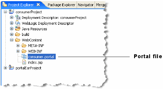

If it is not already open, open the consumerProject/WebContent folder.
Double-click the file consumerPortal.portal in WebContent folder. The portal editor appears in Oracle Enterprise Pack for Eclipse.

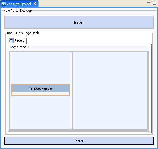

Drag the remoteExample.portlet
file from the Project Explorer to the portal. The result is shown in Figure 4-11.
Figure 4-11 Remote Portlet Placed in Portal

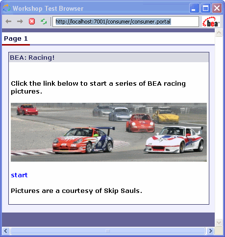

To test the portal, right-click the portal filename, remoteExample.portlet, in the Project Explorer, and select Run As > Run On Server. The New Server – Define a Server dialog appears.
In the Run On Server – Define a New Server dialog, be sure the Oracle WebLogic Server v10.x is selected, and click Finish.
The portal containing the remote portlet appears in a browser, as shown in Figure 4-12.

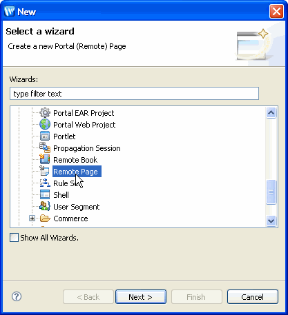

Select File > New > Other.
In the New dialog, select Remote Page (or Remote Book), as shown in Figure 4-13, and click Next.

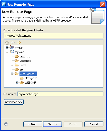

In the New Remote Page dialog, select a folder in which to place the resulting .page
file, and give the file a name, as shown in Figure 4-14, and click Next.

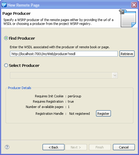

Checkpoint: At this point, the consumer uses the WSDL URL to locate the producer and learn about its available remoteable pages. The Producer Details section of the wizard panel now displays information about the producer, including the number of pages that are available to the consumer, as shown in Figure 4-15.
Click Register in the Producer Details section of the wizard panel, as shown in Figure 4-15. The Register dialog appears.
Tip:
During registration, the producer stores information about the consumer and returns a handle to the consumer. Registration is an optional feature described in the WSRP specification. A WebLogic Portal complex producer implements this option and, therefore, requires consumers to register before discovering and interacting with books and pages offered by the producer. See Section 3.4.2.2, "Complex Producers" for more information.
In the Register dialog, enter a handle name in the Producer Handle field, as shown in Figure 4-6. This handle identifies the producer on the consumer.
Click Register. You are returned to the New Remote Page–Page Producer dialog.
Checkpoint: At this point the WSDL data from the producer has been retrieved and is displayed in the Producer Details panel of the dialog.

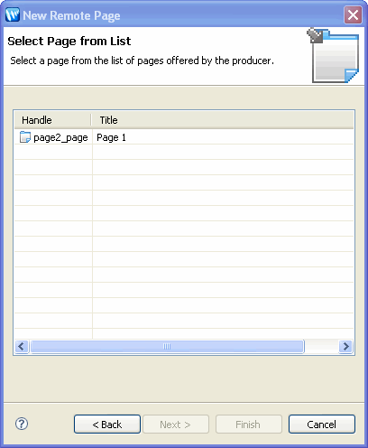

In the Select Page from List dialog, select one of the remote pages from the list of pages offered by the producer, as shown in Figure 4-8, and click Next.
Figure 4-17 Select a Page on the Producer

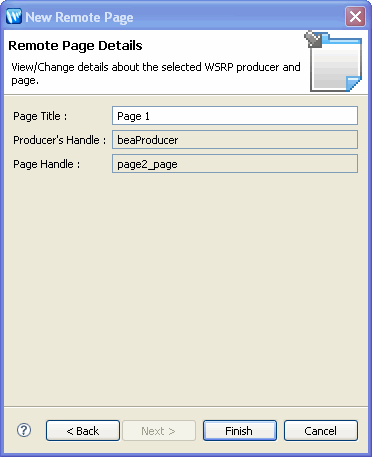

The Remote Page Details dialog appears. The title of the page you selected appears in the Page Title field, as shown in Figure 4-9. You can change this title if you want to.
If the producer does not require registration, the Producer's Handle field will appear editable and uninitialized. In this case, you must enter an arbitrary value for the producer handle before the Finish button will be enabled.
Figure 4-18 The Remote Page Details Dialog
