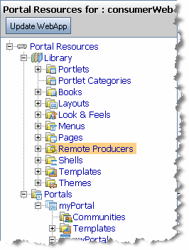

Expand the Library node in the Portal Resources tree and select Remote Producers, as shown in Figure 18-1.

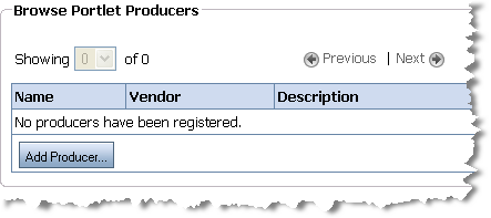

In the Browse Remote Producers window, select Add Producer, as shown in Figure 18-2. The Add Producer wizard appears.

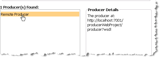

Select the producer you wish to add from the Producer(s) Found list, as shown in Figure 18-3.

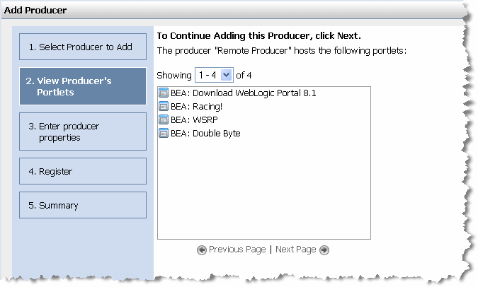

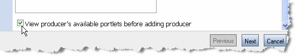

If you want to view a list of portlets hosted by the producer, select the View producer's portlets before adding producer checkbox, as shown in Figure 18-4.
Figure 18-4 View Producer's Portlets Checkbox
Click Next.
If the View Producer Portlets dialog appears, click Next. This dialog, shown in Figure 18-5, appears only if you selected the View producer's portlets before adding producer checkbox. This dialog simply lists the portlets hosted by the selected producer to help you decide if you want to add the producer or not.

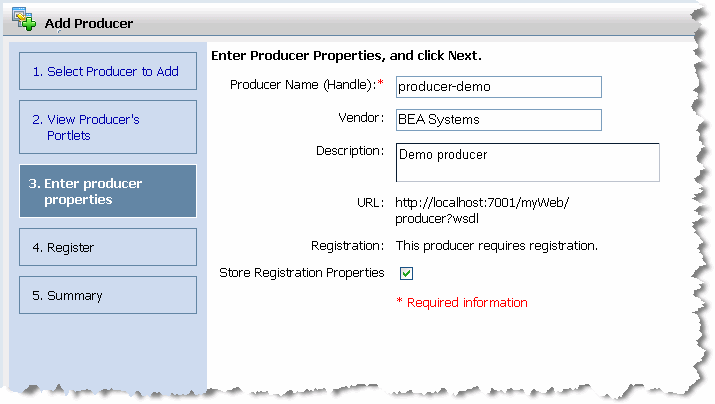

In the Enter Producer Properties dialog (Figure 18-6), enter or select:
A name for the producer – (Required) This name is used by the consumer to identify the producer.
Vendor and description information – (Optional) Use these fields to enter optional metadata.
Store Registration Properties – (Optional) If you select this option, the registration properties that you enter in the Add Producer dialog are stored on the consumer. It is recommended that you select this option. For detailed information on this option, see Section 14.19, "Storing Registration Properties".
Click Add Producer to go to the Register dialog.

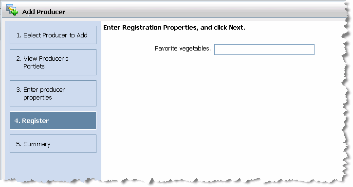

In the Register dialog, enter the registration information, if any is required. In the example shown in Figure 18-6, a property set called "Favorite vegetables" was defined on the producer. The dialog requires the user to enter value(s) from that property set. The value(s) entered here are validated on the producer and are used to determine which resources this consumer is entitled to retrieve. For detailed information on consumer entitlement, see Chapter 11, "Consumer Entitlement."
Figure 18-7 Enter Registration Properties (Sample)

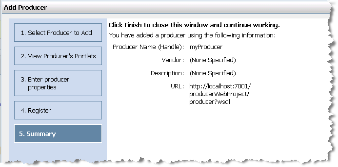

Click Add Producer. The Summary dialog appears, as shown in Figure 18-8.
Click Finish.

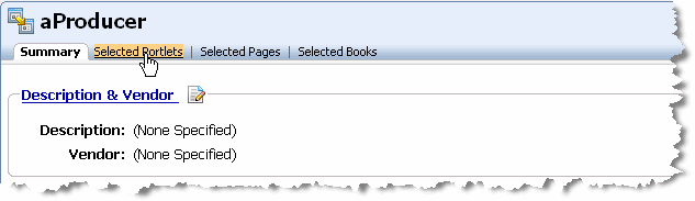

In the Portal Resources tree, open the Library > Remote Producers folder, and select the producer that contains the remote portlet that you want to use, as shown in Figure 18-9.
In the producer window click the Selected Portlets tab, as shown in Figure 18-10.

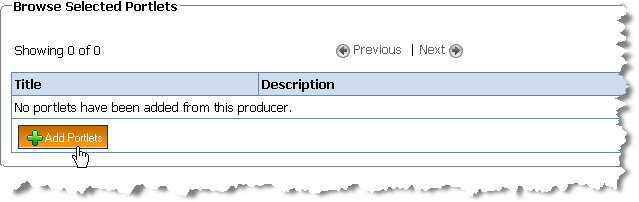

In the Browse Selected Portlets panel, click Add Portlets, as shown in Figure 18-11.

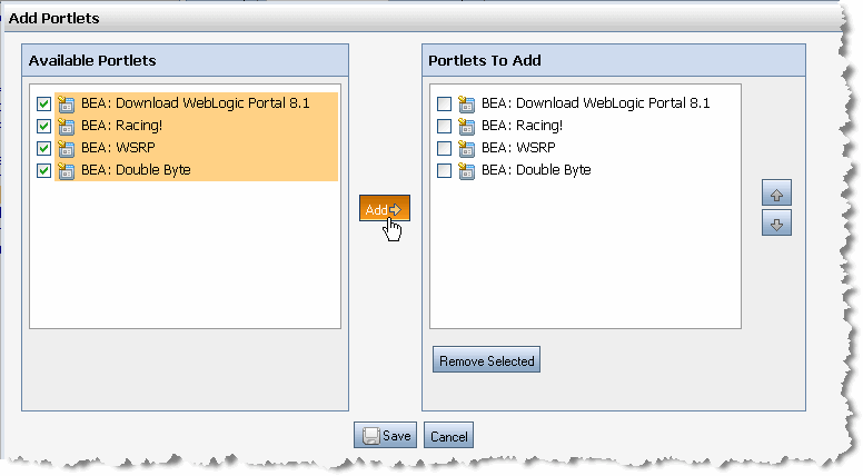

In the Add Portlets dialog, select the remote portlet(s) that you want to add to the Library, and click Add to move the selected portlets to the Portlets To Add column, as shown in Figure 18-12.

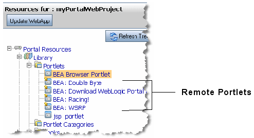

After moving the portlet to the Portlets To Add column, click Save. The portlets you added appears in the Library under the Portlets folder, as shown in Figure 18-13.
Figure 18-13 Remote Portlets Added to the Library

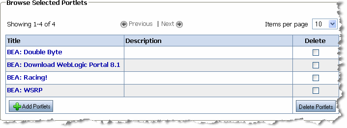

The added portlets also appear in the Browse Selected Portlets table in the producer's Selected Portlets tab, as shown in Figure 18-14.
Figure 18-14 Table Displays Added Portlets

When you add a remote portlet to the Library, it is placed in the Portlets folder. This is the same folder where local portlets appear. WebLogic Portal treats the remote portlet exactly as if it were a local portlet.

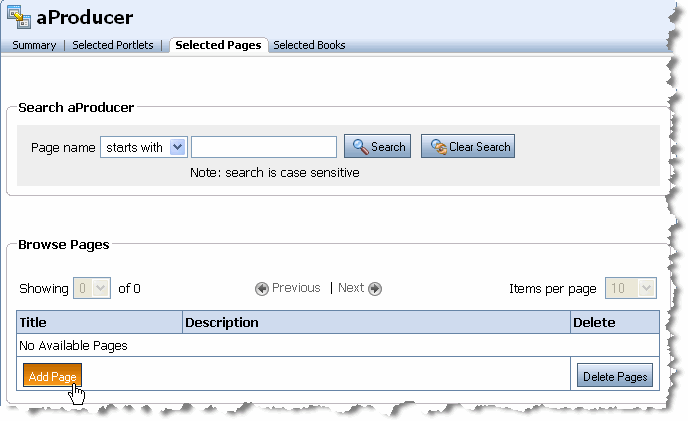

In the producer window, click the Selected Pages tab, as shown in Figure 18-16.

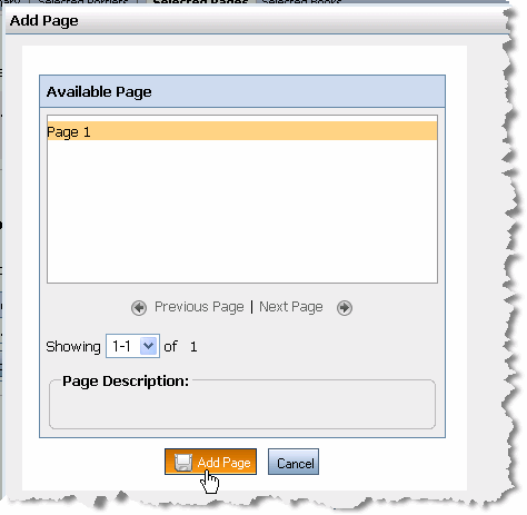

In the Browse Pages section, click Add Page, as shown in Figure 18-17.

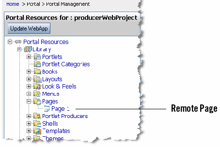

In the Add Page dialog, select the remote page that you want to add to the Library, and click Add Page. In Figure 18-18, the remote page is called Page 1.
Checkpoint: The remote page is added to the Library, as shown in Figure 18-24. You can now add the page to a desktop. For details on adding Library resources to a desktop, see the Oracle Fusion Middleware Portal Development Guide for Oracle WebLogic Portal.
Figure 18-19 Remote Page Added to Library

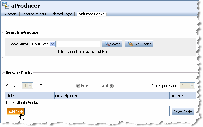

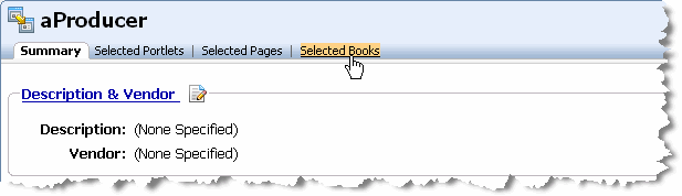

In the producer window, click the Selected Books tab, as shown in Figure 18-21.
In the Browse Books section, click Add Book, as shown in Figure 18-22.
In the Add Book dialog, select the remote book that you want to add to the Library, and click Add Book. In Figure 18-23, the remote book is called My Remote Book.

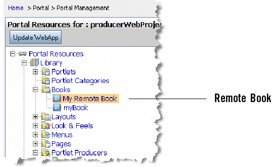

Checkpoint: The remote book is added to the Library, as shown in Figure 18-24. You can now add the book to a desktop. For details on adding Library resources to a desktop, see the Oracle Fusion Middleware Portal Development Guide for Oracle WebLogic Portal.
Figure 18-24 Remote Book Added to Library
