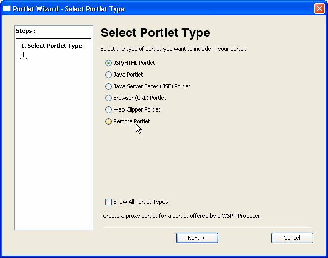

Figure 5-5 Portlet Wizard - Select Portlet Type Dialog
Oracle Enterprise Pack for Eclipse invokes the Portlet Wizard any time you perform one of these operations:

Figure 5-8 shows the default configuration of the Select Portlet Type dialog (assuming the default WebLogic Portal facets are installed in the web project).
Figure 5-8 Portlet Wizard - Select Portlet Type Dialog
The Show All Portlet Types option forces all portlet types to appear in the Select Portlet Type dialog even if their modules were not installed. For information on installing the optional Page Flow and/or Struts support, see "Apache Beehive and Apache Struts Supported Configurations" in the Oracle Fusion Middleware Portal Development Guide for Oracle WebLogic Portal.

The Portlet Wizard displays the Select Portlet Type dialog.
In the Select Portlet Type page, select the Show All Portlet Types checkbox.
Select the Java Page Flow Portlet radio button and click Next.
