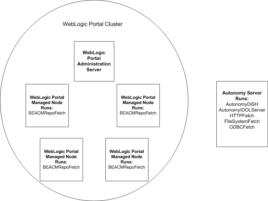

When you move to a production environment, you must configure Autonomy to match the portal environment you use.
This involves editing the configuration files for the search components you are using, deploying the Autonomy Service Dashboard, and configuring Autonomy fetches to search for information according to parameters you set.
The tasks covered in this chapter assume a typical Autonomy configuration running in an Oracle WebLogic Portal cluster. Consult the Autonomy documentation if you want to create a more complex configuration, such as running HTTPFetch on a separate server. Contact Autonomy Corporation to receive the Autonomy documentation.
Figure 7-1 provides an example of a typical production environment.
Figure 7-1 Example of Oracle WebLogic Portal Cluster Using Autonomy

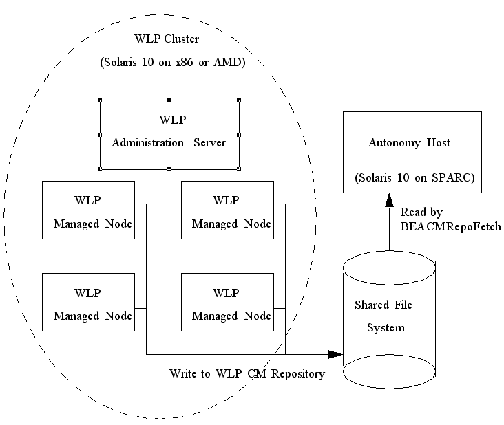

If deploying Oracle WebLogic Portal in a cluster environment, you need to ensure that each machine in your cluster can access the content indexed by File System Fetch, see Section 7.4, "Staging File System Fetch within a WebLogic Cluster."
To set up full-text search for your WLP repositories, you must configure the WLP Content Management fetch and then enable your WLP repositories for full-text search.

Figure 7-2 provides an example of a remote Autonomy installation using a shared file system.
Figure 7-2 Example Remote Autonomy Installation on a non-Oracle WebLogic Portal supported operating system
To configure WLP Content Management search:
Stop all Autonomy services.
Create a shared directory where shared_drive
is the name of your shared drive.
On the Autonomy host, mount shared_drive.
For each managed server in your cluster, mount shared_drive.
Mountshared_drive
with the same exact mapping on each managed server.On each managed server, set the CONTENT_SEARCH_OPTION
environment variable to none
. This prevents Autonomy from starting the content management search.
Using the Oracle WebLogic Portal Administration Console, define a repository property called public.search.staging.area
with a value of shared_drive
. For more information on setting other Autonomy properties, see Section 7.4, "Staging File System Fetch within a WebLogic Cluster."
Use a text editor to modify the <WLPORTAL_HOME>/content-mgmt/thirdparty/autonomy-wlp10/<operating_system_directory>/internal/BEACMRepoFetch/BEACMRepoFetch.cfg
file to point to the shared_drive
you have created. This will ensure that the repository content gets indexed.
