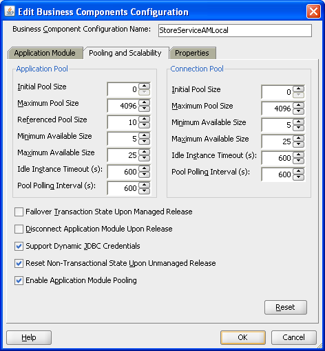

The Pooling and Scalability tab of the Edit Business Components Configuration dialog shown in Figure 44-1 is used for viewing and setting parameters.
Figure 44-1 Pooling and Scalability Tab of the Configuration Manager
To edit your application module's pooling configuration:
  1. In the Application Navigator, double-click the application module.
  2. In the overview editor, click the Configurations navigation tab.
  3. In the Configurations page, double-click the configuration you want to edit.
  4. In the Edit Business Components Configuration dialog, click the Pooling and Scalability tab and edit the desired runtime properties and click OK to save the changes for your configuration.

44.2.7 What You May Need to Know About Application Module Pool Parameters
The application module pool configuration parameters fall into three logical categories relating to pool behavior, pool sizing, and pool cleanup behavior.
44.2.7.1 Pool Behavior Parameters
Table 44-1 lists the application module configuration parameters that affect the behavior of the application module pool.
Table 44-1 Application Module Pool Behavior Configuration Parameters
Pool Configuration Parameter Description
Failover Transaction State Upon Managed Release
(jbo.dofailover)
Enables eager passivation of pending transaction state each time an application module is released to the pool in "Managed State" mode. See Section 43.2.2.2, "How Passivation Changes When Optional Failover Mode is Enabled" for more information.
Fusion web applications should set enable failover (true) to allow any other application module to activate the state at any time.
By default, the failover feature is disabled (jbo.dofailover=false) as a performance optimization when there is only one web server instance configured, by reducing the need for passivation and activation. This allows for application module affinity to a specific user session.
For high availability, enable the failover feature (jbo.dofailover=true) to ensure that more application modules are readily available, thereby increasing scalability. In this mode, passivation occurs at the end of every request.
When failover is enabled, a failure can occur when Oracle WebLogic Server is configured to forcibly release connections back into the pool. A failure of this type produces a SQLException (Connection has already been closed.) that is saved to the server log. To ensure that state passivation occurs and users' changes are saved, the server administrator should set an appropriate value for the weblogic-application.xml deployment descriptor parameter inactive-connection-timeout-seconds on the <connection-check-params> pool params element. Setting the deployment descriptor parameter to several minutes, in most cases, should avoid forcing the inactive connection timeout and the resulting passivation failure. Adjust the setting as needed for your environment.
Row-Level Locking Behavior Upon Release
(jbo.locking.mode)
Forces the application module pool not to create a pending transaction state on the database with row-level locks each time the application module is released to the pool. See Section 43.11.1, "How to Confirm That Applications Use Optimistic Locking" for more information.
Fusion web applications should leave the locking mode set to the default value optimistic to avoid creating the row-level locks.
This feature is disabled when the property is set to pessimistic.
Disconnect Application Module Upon Release
(jbo.doconnectionpooling)
Forces the application module pool to release the JDBC connection used each time the application module is released to the pool. See Section 44.2.6, "What You May Need to Know About How Database and Application Module Pools Cooperate" for more information.
This feature is disabled by default (false).
Transaction Memory State Upon Release
(jbo.txn.disconnect_level)
By default, after the application module is passivated, the view objects and its row sets are closed and removed, to be recreated and reverted to their original state upon activation. This behavior corresponds to the default jbo.txn.disconnect_level=0.
When setting jbo.txn.disconnect_level=1 the application module, view objects and row sets all remain in memory and stay valid but their corresponding references to JDBC objects are dropped. Upon activation, the framework reexecutes and synchronizes the cursor positions.
Setting jbo.txn.disconnect_level=1 can improve performance when enabling application modules to disconnect from their JDBC connection (when used in conjunction with jbo.doconnectionpooling=true) and reduces the memory overhead associated with this situation.
Enable Application Module Pooling
(jbo.ampool.doampooling)
Enables application module pooling by default. Whenever you deploy your application in a production environment the default setting of jbo.ampool.doampooling set to true is the way you will run your application. But, as long as you run your application in a test environment, setting the property to false can play an important role in your testing. When this property is false, there is effectively no application pool. See Section 43.10, "Testing to Ensure Your Application Module is Activation-Safe" for more information.
This feature is enabled by default (true).
Support Dynamic JDBC Credentials
(jbo.ampool.dynamicjdbccredentials)
Enables additional pooling lifecycle events to allow developer-written code to change the database credentials (username/password) each time a new user session begins to use the application module.
This feature is enabled by default (true), however this setting is a necessary but not sufficient condition to implement the feature. The complete implementation requires additional developer-written code.
Reset Non-Transactional State Upon Unmanaged Release
(jbo.ampool.resetnontransactionalstate))
Forces the application module to reset any non-transactional state like view object runtime settings, JDBC prepared statements, bind variable values, etc. when the application module is released to the pool in unmanaged or "stateless" mode.
This feature is enabled by default (true). Disabling this feature can improve performance, however since it does not clear bind variable values, your application needs to ensure that it systemically sets bind variable values correctly. Failure to do so with this feature disabled can mean one user might see data with another users bind variable values.)
44.2.7.2 Pool Sizing Parameters
Table 44-2 lists the application module configuration parameters that affect the sizing of the application module pool.
Table 44-2 Application Module Pool Sizing Configuration Parameters
Initial Pool Size
(jbo.ampool.initpoolsize)
The number of application module instances to created when the pool is initialized.
The default is 0 (zero) instances. A general guideline is to configure this to 10% more than the anticipated number of concurrent application module instances required to service all users.
Creating application module instances during initialization takes the CPU processing costs of creating application module instances during the initialization instead of on-demand when additional application module instances are required.
Maximum Pool Size
(jbo.ampool.maxpoolsize)
The maximum number of application module instances that the pool can allocate. The pool will never create more application module instances than this limit imposes.
The default is 4096 instances. A general guideline is to configure this to 20% more than the initial pool size to allow for some additional growth. If this is set too low, then some users may see an error accessing the application if no application module instances are available.
Referenced Pool Size
(jbo.recyclethreshold)
The maximum number of application module instances in the pool that attempt to preserve session affinity for the next request made by the session which used them last before releasing them to the pool in managed-state mode.
The referenced pool size should always be less than or equal to the maximum pool size. The default is to allow 10 available instances to try and remain "loyal" to the affinity they have with the most recent session that released them in managed state mode.
Configure this value to maintain the application module instance's affinity to a user's session. A general guideline is to configure this to the expected number of concurrent users that perform multiple operations with short think times. If there are no users expected to use the application with short think times, then this can be configured to 0 zero to eliminate affinity.
Maintaining this affinity as much as possible will save the CPU processing cost of needing to switch an application module instance from one user session to another.
Maximum Instance Time to Live
(jbo.ampool.timetolive)
The number of milliseconds after which to consider an application module instance in the pool as a candidate for removal during the next resource cleanup regardless of whether it would bring the number of instances in the pool below minavailablesize.
The default is 3600000 milliseconds of total time to live (which is 3600 seconds, or one hour). The default value is sufficient for most applications.
44.2.7.3 Pool Cleanup Parameters
A single "application module pool monitor" per Java VM runs in a background thread and wakes up every so often to do resource reclamation. Table 44-3 lists the parameters that affect how resources are reclaimed when the pool monitor does one of its resource cleanup passes.
Best Practice:
When you specify the length of time between application module pool cleanup passes, set all application modules to use the same Pool Polling Interval value. Since there is only a single application monitor pool monitor per Java VM, the value that will effectively be used for the application module pool monitor polling interval will be the value found in the application module configuration read by the first application module pool that gets created. Setting all application modules to use the same value ensures that this value is set in a predictable way.
Table 44-3 Application Module Resource Management Configuration Parameters
(jbo.ampool.monitorsleepinterval)
The length of time in milliseconds between pool resource cleanup.
While the number of application module instances in the pool will never exceed the maximum pool size, available instances which are candidates for getting removed from the pool do not get "cleaned up" until the next time the application module pool monitor wakes up to do its job.
The default is to have the application module pool monitor wake up every 600000 milliseconds (which is 600 seconds, or ten minutes). Configuring a lower interval results in inactive application module instances being removed more frequently to save memory. Configuring a higher interval results in less frequent resource cleanups.
Maximum Available Size
(jbo.ampool.maxavailablesize)
The ideal maximum number of available application module instances in the pool when not under abnormal load.
When the pool monitor wakes up to do resource cleanup, it will try to remove available application module instances to bring the total number of available instances down to this ideal maximum. Instances that have been not been used for a period longer than the idle instance time-out will always get cleaned up at this time, then additional available instances will be removed if necessary to bring the number of available instances down to this size.
The default maximum available size is 25 instances. Configure this to leave the maximum number of available instances desired after a resource cleanup. A lower value generally results in more application module instances being removed from the pool on a cleanup.
Minimum Available Size
(jbo.ampool.minavailablesize)
The minimum number of available application module instances that the pool monitor should leave in the pool during a resource cleanup operation.
Set to 0 (zero) if you want the pool to shrink to contain no instances when all instances have been idle for longer than the idle time-out after a resource cleanup.
The default is 5 instances.
Idle Instance Timeout
(jbo.ampool.maxinactiveage)
The number of milliseconds after which to consider an inactive application module instance in the pool as a candidate for removal during the next resource cleanup.
The default is 600000 milliseconds of idle time (which is 600 seconds, or ten minutes). A lower value results in more application module instances being marked as a candidate for removal at the next resource cleanup. A higher value results in fewer application module instances being marked as a candidate for removal at the next resource cleanup.
The number of milliseconds after which to consider an connection instance in the pool as a candidate for removal during the next resource cleanup regardless of whether it would bring the number of instances in the pool below minavailablesize.
The default is 3600000 milliseconds of total time to live (which is 3600 seconds, or one hour). A lower value reduces the time an application module instance can exist before it must be removed at the next resource cleanup. The default value is sufficient for most applications. A higher value increases the time an application module instance can exist before it must be removed at the next cleanup.

44.2.9 What You May Need to Know About Database Connection Pool Parameters
If you are using a JDBC URL for your connection information so that the ADF database connection pool is used, then configuration parameters listed in Table 44-5 can be used to tune the behavior of the database connection pool. A single "database connection pool monitor" per Java VM runs in a background thread and wakes up every so often to do resource reclamation. The parameters in Table 44-3 include the ones that affect how resources are reclaimed when the pool monitor does one of its resource cleanup passes.
The configuration parameters for database connection pooling have MetaObjectManager scope (described in Section 44.2.5, "What You May Need to Know About Configuration Property Scopes" earlier). This means their settings are global and will be set once when the first application module pool in your application is created. To insure the most predictable behavior, leave the values of these parameters in the Connection Pool section of the Pooling and Scalability tab at their default values — so that no entry for them is written into the bc4j.xcfg file — and to instead set the desired values for the database connection pooling tuning parameters as Java System Parameters in your Java EE container.
Table 44-5 Database Connection Pool Parameters
Initial Pool Size
(jbo.initpoolsize)
The number of JDBC connection instances to created when the pool is initialized
The default is an initial size of 0 instances.
Maximum Pool Size
(jbo.maxpoolsize)
The maximum number of JDBC connection instances that the pool can allocate.
The pool will never create more JDBC connections than this imposes. The default is 4096 instances.
(jbo.poolmonitorsleepinterval)
While the number of JDBC connection instances in the pool will never exceed the maximum pool size, available instances which are candidates for getting removed from the pool do not get "cleaned up" until the next time the JDBC connection pool monitor wakes up to do its job.
The default is 600000 milliseconds of idle time (which is 600 seconds, or ten minutes). Configuring a lower interval results in inactive connection instances being removed more frequently to save memory. Configuring a higher interval results in less frequent resource cleanups.
(jbo.poolmaxavailablesize)
The ideal maximum number of JDBC connection instances in the pool when not under abnormal load.
When the pool monitor wakes up to do resource cleanup, it will try to remove available JDBC connection instances to bring the total number of available instances down to this ideal maximum. Instances that have been not been used for a period longer than the idle instance time-out will always get cleaned up at this time, then additional available instances will be removed if necessary to bring the number of available instances down to this size. The default is an ideal maximum of 25 instances (when not under load).
(jbo.poolminavailablesize)
The minimum number of available JDBC connection instances that the pool monitor should leave in the pool during a resource cleanup operation. Set to zero (0) if you want the pool to shrink to contain no instances when all instances have been idle for longer than the idle time-out.
The default is to not let the minimum available size drop below 5 instances.
(jbo.poolmaxinactiveage)
The number of seconds after which to consider an inactive JDBC connection instance in the pool as a candidate for removal during the next resource cleanup.
Notice that since the database connection pool does not implement the heuristic of session affinity, there is no configuration parameter for the database connection pool which controls the referenced pool size.
