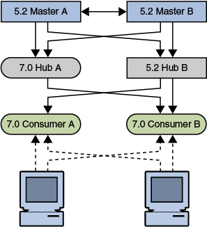

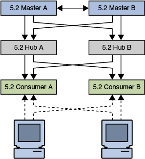

The following sequence of diagrams illustrate the migration of a master, as described above. The first diagram shows the topology before the migration of the masters.
Figure 8-9 Topology With Consumers and Hubs Migrated
The first step in migrating a master involves disabling replication agreements, effectively isolating the master from the topology.

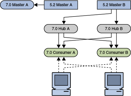

The next step involves migrating a master.
The next step involves enabling the replication agreements to and from the new master and initializing the master if necessary.
Figure 8-12 Placing the 11g Release 1 (11.1.1.7.0) Master Into the Topology
