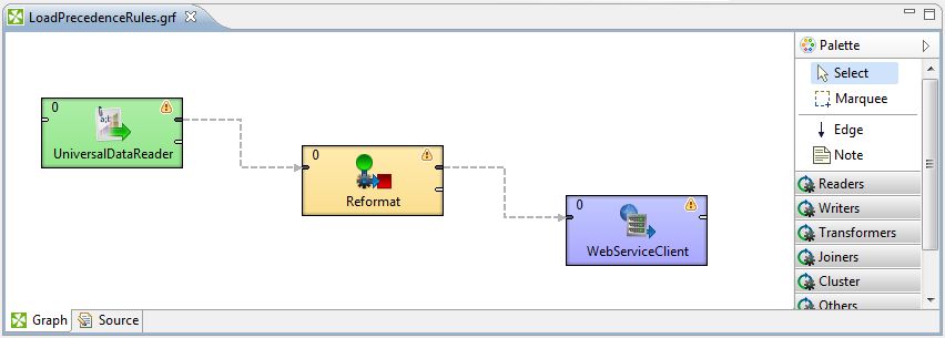

You must add the UniversalDataReader, Reformat, and WebServiceClient components to the graph.
This procedure assumes that you have created an empty graph.
To add components to the graph:
  1. In the Palette pane, drag the following components into the Graph Editor:
    1. Drag the UniversalDataReader component from the Readers section.
    2. Drag the Reformat component from the Transformers section.
    3. Drag the WebServiceClient component from the Others section.
  2. In the Palette pane, click Edge and use it to connect the components.
  3. From the File menu, click Save to save the graph.
At this point, the Graph Editor with the connected components should look like this:
