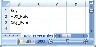

To delete precedence rules from the MDEX Engine:
  1. Create an input file that contains one column, with a Key header name and with one or more rows of precedence rule names, as in this simple CSV example:
