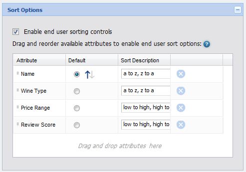

  3. If the Sorting checkbox is checked, then the Sort Options section is updated to allow you to provide a list of attributes end users can use to sort the list.
    Results List - Sort Options when sorting on
    To add an attribute, drag the attribute from the Attributes List to the Sort Options table.
    In the Available Attributes list, you can use the filter field to find the attribute you want to use.
  4. To determine the order of the attributes in the Sorted by drop-down list, drag each row up and down in the list.
    Results List with sorting attributes selected
  5. For the attribute you want to use for the default sort order:
    1. Click the Default radio button next to the attribute.
    2. To sort by that attribute in ascending order, click the up arrow.
    3. To sort by that attribute in descending order, click the down arrow.
  6. From the Sort Description drop-down list, select the text that displays next to the attribute in the Sorted by list.

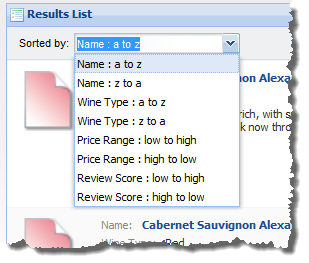

    For each attribute, the Sorted by drop-down list includes one entry for sorting in ascending order, and one for sorting in descending order.
    Results List - Sorted by drop-down list
