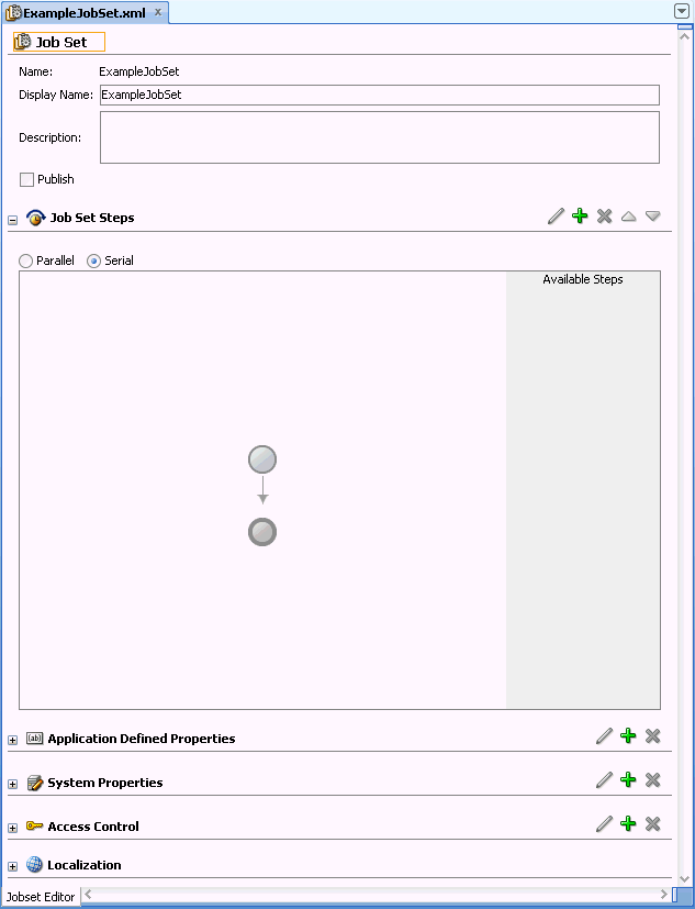

To create a job set:
In Oracle JDeveloper, right-click in the project to view the New Gallery.
In the All Technologies tab, under Categories, expand Business Tier and select Enterprise Scheduler Metadata.
Under Items, select Job Set and click OK. This displays the Create Job Set window.
In the Create Job Set window, specify the following:
In the Name field, enter a name for the job set or accept the default name.
In the Package field, optionally enter a package name for the job set.
The Location field displays the full path of the directory where the job set file is stored.
Click OK. This creates the job set and displays the Job Set Definition page, as shown in Figure 12-1.
In the Job Set Editor pane, in the Description field enter a description for the job set.
In the Job Set Steps area, select the Parallel or Serial radio button to specify parallel or serial execution mode for the job set.
In the Job Set Editor pane add the job set steps. For more information on adding job set steps, see Section 12.2.2, "How to Define Serial Job Set Steps" or Section 12.2.3, "How to Define Parallel Job Set Steps".
In the Application Defined Properties area, click Add to add properties associated with the job set. You use these to represent an application-specific or step-specific application defined property for the job set. For more information on using application defined properties, see Section 7.1, "Introduction to Using Parameters and System Properties". For more information, see Section 7.1.2.2, "What You Need to Know About Job Set Level Parameter Materialization".
In the System Properties area, click Add to add system properties associated with the job set. For more information on using system properties, see Section 7.4, "Using System Properties".
In the Access Control area, click Add to modify the list of roles that have access to this metadata, along with their access levels. For more information on defining access, see Section 18.2.3, "How to Create Grants with Oracle Enterprise Scheduler Metadata Pages".
In the Localization area, enter the following information for localizing this job set:
Resource Bundle Base Name -- The base name for the resource bundle that specifies internationalized values.
Display Name Resource Key -- The resource key that specifies the display name value in the resource bundle.
Description Resource Key -- The resource key that specifies the description text in the resource bundle.
Save the job set.

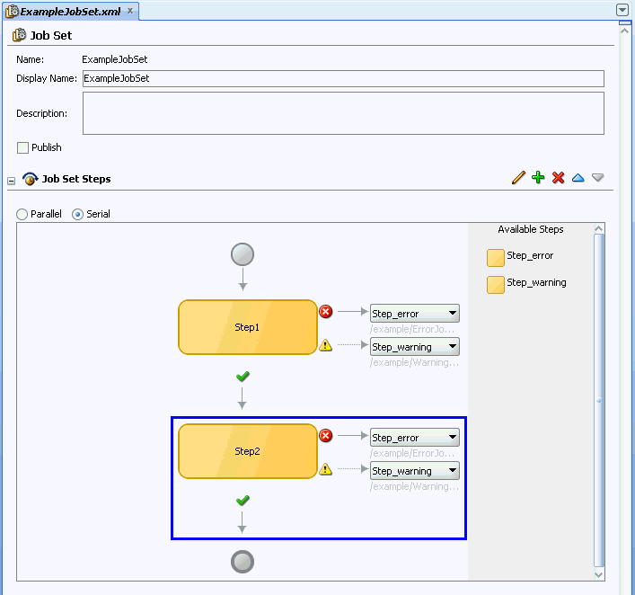

To add serial job set steps:
First, define the appropriate job definitions or job sets and define the parent job set to contain the steps.
In the Job Set Editor pane, in the Job Set Steps area, select Serial execution mode.
Click the Add icon to add a job set step. This displays the Add Step window.
In the Step ID field, enter the step ID. For example, enter step1.
In the Job field, from the dropdown list select a job definition or a job set to associate with the step. For example, select Job1.
If you need to define step level application defined properties, then select the Application Defined Properties tab and add properties for the step.
If you need to define step level system properties, then select the System Properties tab and add job set step system properties for the step.
Select a destination for the step. The step can be added as part of the job set by selecting Insert into main diagram. To make the step available for use in another step, for either error or warning states, select Add to list of available steps.

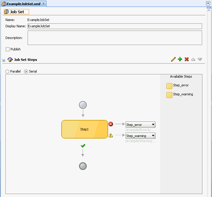

Click OK, this adds the job set step, as shown in Figure 12-2.
From the dropdown list next to the error icon, select Stop or select the step for the ERROR terminal state for the step. For example, from the dropdown list select Step_error (Step_error needs to be defined).
From the dropdown list next to the warning icon, select Stop or select the step for the WARNING terminal state for the step. For example, from the dropdown list select Step_warning (Step_warning needs to be defined).
Click the Add icon and add additional steps as needed.
Click OK, as shown in Figure 12-3.

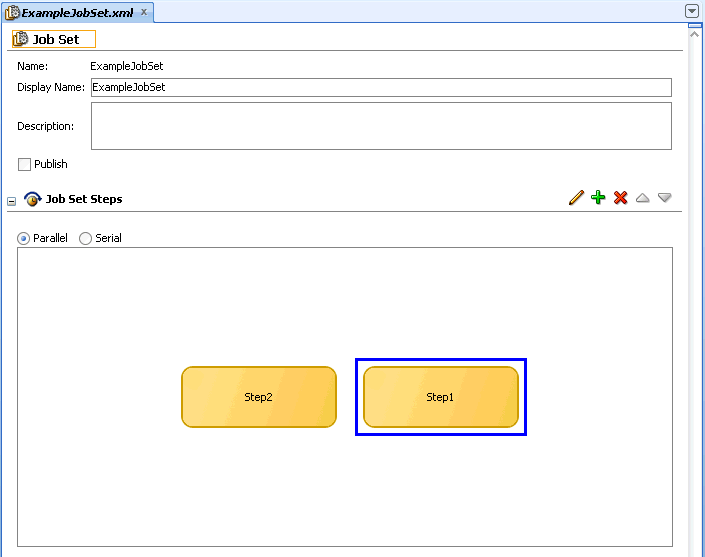

You can add parallel job set steps to a job set.
To add parallel job set steps:
First, define the appropriate job definitions and job set definitions and the parent job set.
In the Job Set Editor, select the Parallel execution mode.
Click the Add icon to add a job set step to the job set.
The Add Step window displays.
In the Job field, select a job definition or a job set.
Click OK, this adds the job set step.
Click the Add icon.
In the Add Step dialog, select the job set or job definition to use for next job in the parallel job set.
Click OK. The job set step displays in the job set, as shown in Figure 12-4.

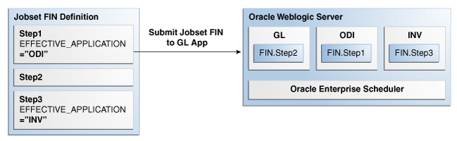

Oracle Enterprise Scheduler provides the capability for a job or a job set to execute across multiple applications as shown in Figure 12-5:
Job set FIN has three steps, two of which are defined to execute in different applications.
Job set FIN is submitted to the GL application.
Step 1 has the EFFECTIVE_APPLICATION system property set to ODI, so Step 1 executes in the ODI application.
Step 2 does not have an effective application set, so it executes in the GL application.
Step 3 has the EFFECTIVE_APPLICATION system property set to INV, so Step 3 executes in the INV application.
