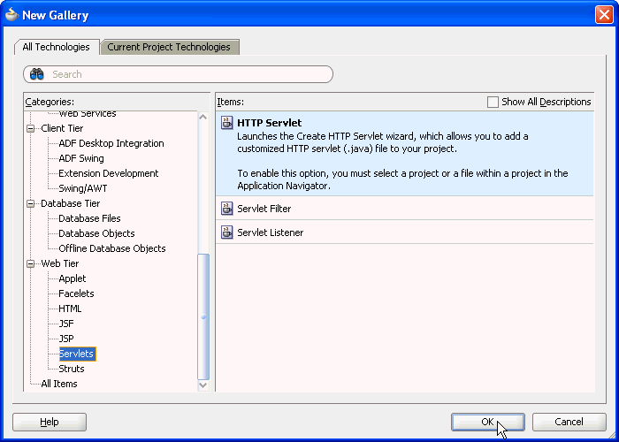

To add a servlet to support job request submissions:
In the Application Navigator, select the EssClient project.
Press Ctrl-N. This displays the New Gallery.
In the New Gallery, in the Categories area, expand Web Tier and select Servlets.
In the Items area, select HTTP Servlet as shown in Figure 4-3.
Click OK. This displays the Create HTTP Servlet wizard.

To create the HTTP Servlet for the front-end submitter application:
Right-click the SuperEss project and choose New.
In the New Gallery, expand Web Tier, select Servlets and then HTTP Servlet, and click OK.
In the Web Application page of the Web Application wizard, select Servlet 2.5\JSP 2.1 (Java EE 1.5).
In the Create HTTP Servlet - Step 1 of 3: Servlet Information page, enter EssDemoAppServlet
in the Class field.
Enter oracle.apps.ess.howto
in the Package field and click Next.
Click Finish.
