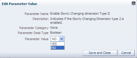

Boolean
Use the list to select either Yes or No.

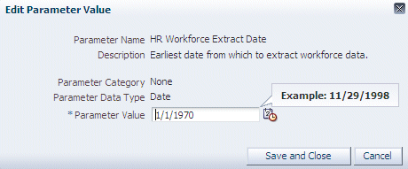

Date
Use the field to type a date in the format MM/DD/YYYY, or use the Date Picker to select a date.

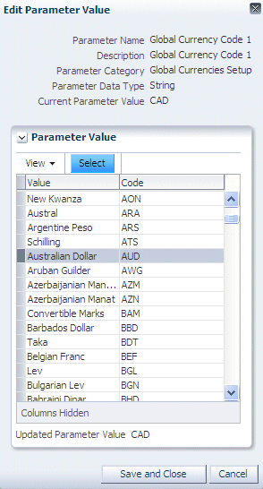

Table for Single Values
Use the table to select a single value, then click Save and Close to complete the selection.
If the table is empty, click Retrieve Source Values first to populate the table.

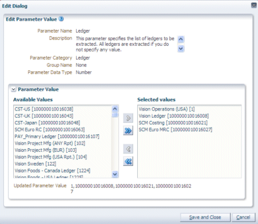

Multi-value Select List of Values
Move the items that you want to select from the Available Values list to the Selected Values list. Use Ctrl + click to select multiple non-contiguous values. Use Shift + click to select multiple contiguous values.
Click Retrieve Source Values to refresh the Available Values. For example, if you have access to more than one data source, you might use the Source Instance field to select a different data source, then you might click Retrieve Source Values to populate the Available Values list.

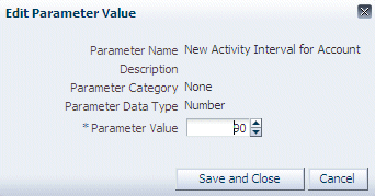

Number
Use the field to type a number, or use the spinner controls to increase or decrease the number.
Single-value Select List of Values
Click a value in the list, click Select, then click Save and Close. Note: If you do not click Select before first clicking Save and Close, the changes are not saved.

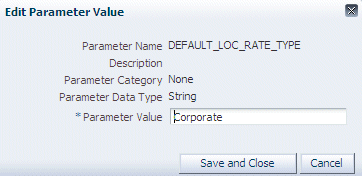

String
Use the field to type a value.

Use this dialog to verify that Data Load Parameter values have been set correctly, and edit values where necessary. For example, you might want to change a Global Currency Code value from USD to EUR.
The Data Load Parameters pane (or master table) displays parameters and values, and the Group Specific Parameter Values for: pane displays associated Fact Groups or Dimension Groups (if there are any) and their values. You can specify different values for associated Fact Groups and Dimension Groups, except for Non-Overridable Application Specific parameters (for more information, see Section 6.5.1, "Key points about working with Data Load Parameters").
Tip: Use the Restore Pane arrow in the bottom right-hand corner of the dialog to display parameter details in the Context Pane (for more information, see Section 4.8.1, "About the Work Area").
Note: For information about the icons used on this dialog, see Section C.17.1, "Icons on the Data Load Parameters dialog".
| Element | Description |
Data Load Parameters |
Use this list to navigate and edit Data Load Parameters. Options:
Columns:
Group Specific Parameter Values for: |
Use this list to view and edit parameter values for associated Fact Groups and Dimension Groups. The parameter values specified in this pane are specific to a Fact Group or Dimension Group. For example, you might specify the Time Grain as MONTH for the Order Fulfilment Fact Group, and the Time Grain as WEEK for the Purchase Cycle Fact Group. Note: Global Parameters that are not associated with any Fact Groups or Dimension Groups do not show any records in this table. Options:
Columns:
Search (Only displayed when this dialog is invoked directly from Oracle BI Applications Configuration Manager. Search is not available when this dialog is invoked from FSM.) |
For User Assistance on the Search pane, see Section C.26, "Search pane". |
Common Options |
For information about using common options in Oracle BI Applications Configuration Manager, refer to the following:
Related Topics
Section 6.5.4, "About Editing Application Specific Parameter Values"
Section 6.5.5, "How to Edit a Data Load Parameter value"
