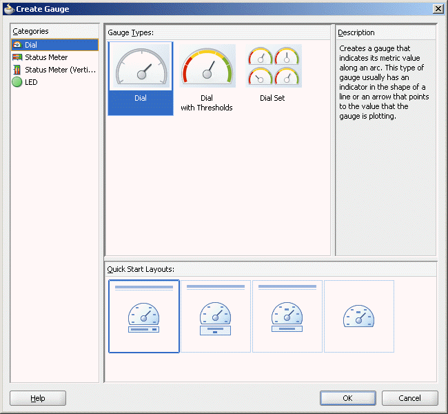

A Component Gallery displays available gauge categories, types, and descriptions to provide visual assistance when creating gauges and using a quick-start layout. Figure 25-1 shows the Component Gallery for gauges.
When a gauge component is inserted into a JSF page using the Component Gallery, a set of child tags that support customization of the gauge is automatically inserted. Example 25-1 shows the code inserted in the JSF page for a dial gauge with the quick-start layout selected in the Component Gallery in Figure 25-1.

The following types of gauges are supported by the gauge component:

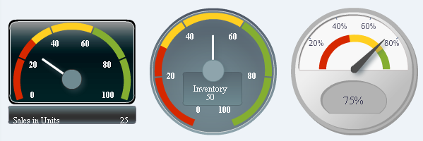

Dial: Indicates its metric along a 220 degree arc. This is the default gauge type. Figure 25-2 shows a dial gauge indicating a Plasma HD TV stock level within an acceptable range.
Status Meter: Indicates the progress of a task or the level of some measurement along a rectangular bar. An inner rectangle shows the current level of a measurement against the ranges marked on an outer rectangle. Figure 25-3 shows the Plasma HD TV stock level using a status meter gauge.
Status Meter (vertical): Indicates the progress of a task or the level of some measurement along a vertical rectangular bar. Figure 25-4 shows the Plasma HD TV stock level using a vertical status meter gauge.

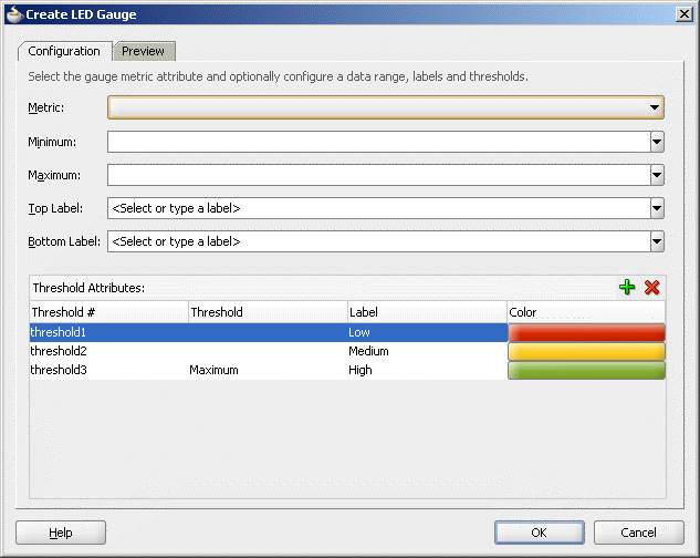

LED (light-emitting diode): Graphically depicts a measurement, such as a key performance indicator (KPI). Several styles of graphics are available for LED gauges, such as arrows that indicate good (up arrow), fair (left- or right-pointing arrow), or poor (down arrow). Figure 25-5 shows the Plasma HD TV stock level using a LED bulb indicator.
Figure 25-6 shows the same stock level using a LED arrow.

Threshold Set: Specifies the threshold sections for the metrics of a gauge. You can create an infinite number of thresholds for a gauge.
Data values: These include the metric (which is the actual value that the gauge is plotting), minimum value, maximum value, and threshold values. Section 25.2, "Understanding Data Requirements for Gauges" describes these values.

Figure 25-11 shows a dial gauge displayed with each of the custom shapes styles applied.
