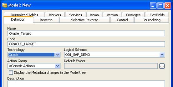

  2. In the Models tree view, click Insert Model.
  3. In the Definition tab, enter the model parameters as shown below:
    Description of image018.jpg follows

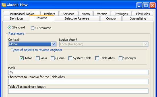

  4. In the Reverse tab, select the Global context.
    Description of image020.jpg follows

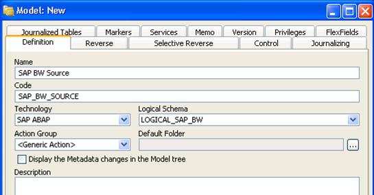

Creating the Data Model
  1. In the Models tree view, click Insert Model.
  2. In the Definition tab, enter the model parameters as shown below. You must select the SAP ABAP technology and the Logical Schema previously created (in our example it is the LOGICAL_SAP_BW Logical Schema ).
    Description of image024.jpg follows

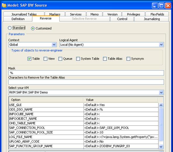

  2. In the Reverse tab:
    1. Select the Global context.
    2. Select the Customized option.
    3. Select the RKM SAP BW you have imported in the SAP BW Demo project.
    4. Set the USE_GUI KM option to Yes.
    5. For first time RKM use only: Set SAP_TRANSPORT_LAYER_NAME to the name of the transport layer your SAP basis admin has provided you with.
      Caution:
      Pay particular attention to provide the correct value for the SAP_TRANSPORT_LAYER_NAME option. If an invalid value is used during the first time installation, a significant delay in the connector installation may be caused.
    6. For first time RKM use only: If you are using a custom value for KM option SAP_FUNCTION_GROUP_NAME, this function group must not exist prior the first execution of the RKM (ABAP_UPLOAD=true).
    7. For first time RKM use only: Set UPLOAD_ABAP_CODE to Yes. After the first execution this value must be set back to No.
    8. Set other parameters according to your SAP configuration. See the Oracle Fusion Middleware Application Adapters Guide for Oracle Data Integrator for more information on the RKM options.
      Description of image028.jpg follows

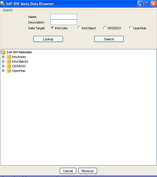

Using the SAP Metadata Browser
As you have set the USE_GUI option to Yes, the RKM displays in the SAP BW Metadata Browser the SAP objects organized in the tree view as shown below.
In case that the below dialog does not show up, see ODI Operator for details and read the log file <System Temp Dir>/sap_rkm_bw_<ODI Session Number>.log.
Refer to Section 7.7.4, "Log Files," in Oracle Fusion Middleware Application Adapters Guide for Oracle Data Integrator for more details.
Description of image030.jpg follows
The Tree View
The SAP BW Data targets are organized into a tree view. Only the SAP BW Data targets available in the SAP BW system are displayed. By expanding the tree view, you can see Info Cubes, Info Objects, ODS/DSO, Open Hub, and select those that you want to reverse-engineer.
Note that only the data targets selected in the tree view are reverse-engineered.
Description of image032.jpg follows

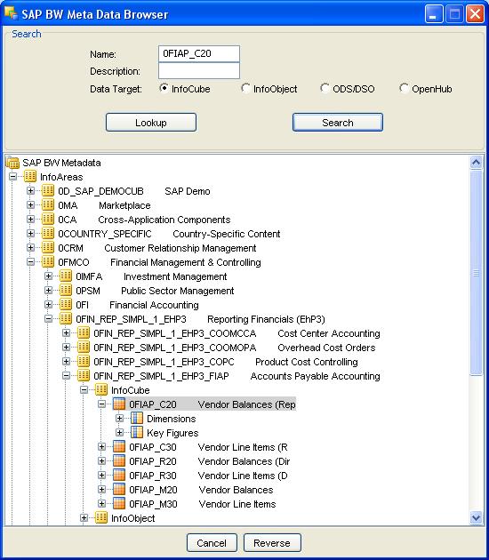

The Search Panel
The Search option group allows you search specific objects in the browser, based on:
  • Info Cube Name
  • Info Object Name
  • ODS/DSO
  • Open Hub
For the example project for Info Cube, the data target 0FIAP_C20 is used:
  1. Enter 0FIAP_C20 in the Name field.
  2. Select the InfoCube data target.
  3. Click Search to find the object to reverse-engineer. The results are highlighted in the tree view.
  4. Click Reverse.
  5. Oracle Data Integrator starts the reverse-engineering process on the selected data target. The reverse-engineered data targets appear under the Model.
