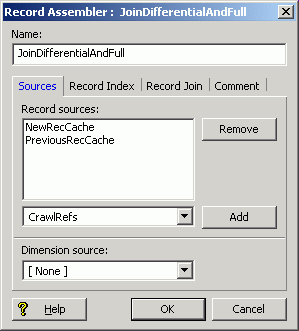

Sources tab of the record assembler
The Sources tab of the Record Assembler editor should look like this:
The two record sources are the PreviousRecCache and NewRecCache record caches. The order in which you add these record sources is not important, because their priority is set in the Record Join tab (below).
Note also that no dimension source is specified for the assembler.

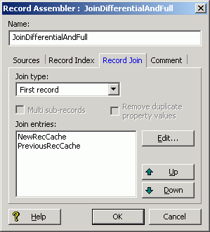

Record Join tab of the record assembler
The Record Join tab should look like this:
The selected join type is First record. Note that the NewRecCache component (which is the source for records from the current crawl) has a higher priority than the PreviousRecCache component (the source for records from the previous crawl).
