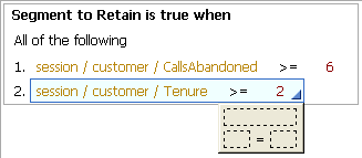

In the example shown in Figure 4-2, the population segment called Segment to Retain has the Customer Retention business goal heavily weighted in its favor (71%), while the remaining population has maximizing revenue as a priority (29%).
If there is a special circumstance or a change in population, you can adjust this prioritization by sliding the weighting bar. Once adjusted, you must redeploy your Inline Service and log in to Decision Center again to see your changes.

The Rule Editor toolbar provides access to features used to edit rules. This toolbar is sensitive to the context of the task you are performing.
From left to right, the toolbar functions are as follows:

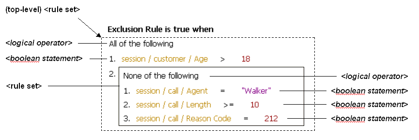

A rule set (as denoted by <rule set> in Table 4-1) is a composite statement, that consists of one or more numbered rule entries, each of which is either a boolean statement or another rule set.
A boolean statement (as denoted by <boolean statement> in Table 4-1) contains a condition that evaluates to true or false when the rule is processed. The boolean statement is the lowest-level element of a rule set - it cannot be decomposed further.
You can optionally name the rule sets defined within higher-level rule sets.
Each Oracle RTD rule has an implicit, unnamed, top-level rule set.
Each rule set is qualified by a logical operator, which controls the processing of the rule set statements. See "Logical Operators" for more information.
The following Exclusion Rule example shows a rule set within a rule set.
In the example:
The top-level unnamed rule set contains the logical operator All of the following and two rule entries. The first rule entry is a boolean statement, the second rule entry is a rule set.
The rule set inside the top-level rule set contains the logical operator None of the following and three rule entries, each of which is a boolean statement.

By default, boolean statements have two operands, with an intervening operator.
To switch between single and double operands in boolean statements, click the line number of the boolean statement, then click the arrowhead icon in the lower-right corner of the boolean statement box, as in the following example:
Single operands always evaluate to a Boolean.
Click the operator, then click the lower-right corner to select an operator:
Table 4-2 lists the available operators.
Table 4-2 Rule Operators
| Operator | Description |
| none | A simple expression that has only one operand |
| = | Left is equal to Right |
| <> | Left is not equal to Right |
| < | Left is less than Right |
| <= | Left is less than or equal to Right |
| > | Left is greater than Right |
| >= | Left is greater than or equal to Right |
| in | Left value is contained in a List on the Right side |
| not in | Left value is not contained in a List on the Right side |
| includes all of | Left list includes all the values of the Right list |
| excludes all of | Left list contains none of the values of the Right list |
| includes any of | Left list includes any one of the values of the Right list |
| does not include all of | Left list does not include all of the values of the list on the Right |
To edit the boolean statements of a rule, click the left side, then click the ellipsis. You can choose from a constant, attribute, or function call. Select Array at the top of the page to specify an array value.
