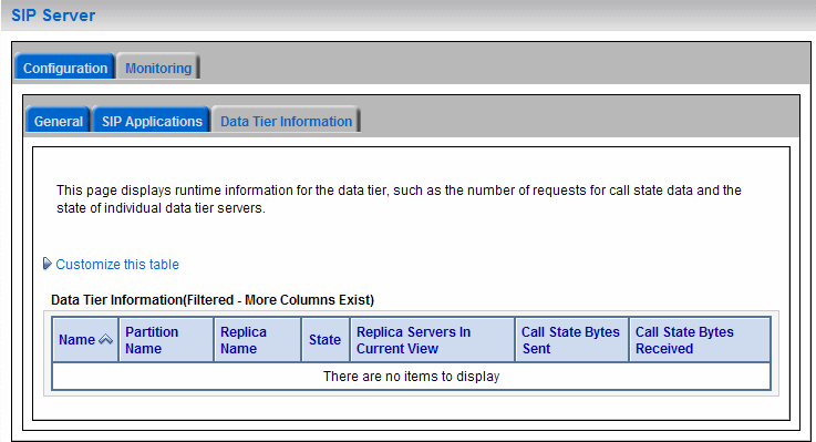

Section 6.8, "Monitoring and Troubleshooting SIP Data Tier Servers"

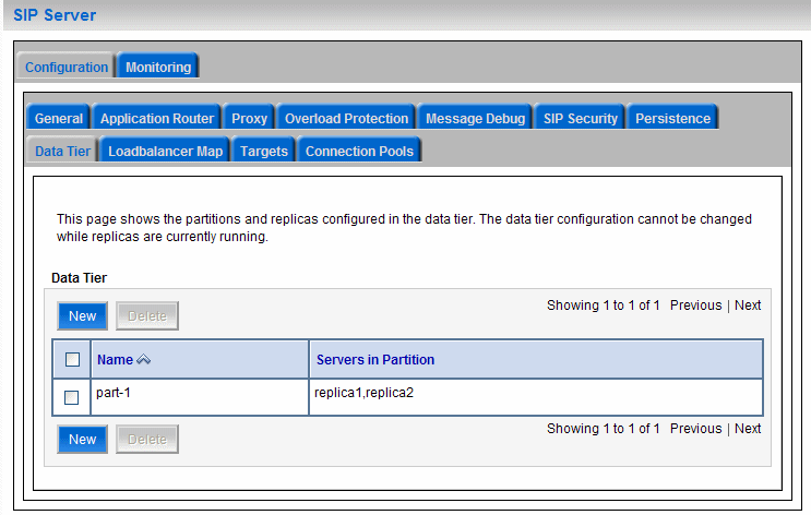

You can view the current SIP data tier configuration (and configure the data tier) using the Configuration > Data Tier page (SipServer node) of the Administration Console, as shown in Figure 6-1.
Figure 6-1 Administration Console Display of SIP Data Tier Configuration (Read-Only)

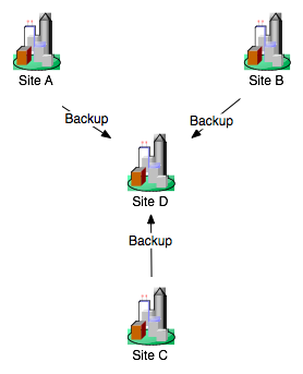

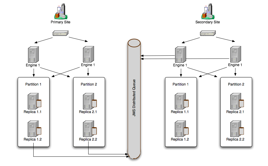

Geo-Redundancy ensures uninterrupted transactions and communications for providers, using geographically-separated SIP server deployments.
A primary site can process various SIP transactions and communications and upon determining a transaction boundary, replicate the state data associated with the transaction being processed, to a secondary site. Upon failure of the primary site, calls are routed from the failed primary site to a secondary site for processing. Similarly, upon recovery, the calls are re-routed back to the primary site.
In the preceeding figure, Geo-Redundancy is portrayed. The process proceeds in this manner:
Call is initiated on a primary OCCAS Cluster site, call setup and processing occurs normally.

An alternate configuration utilizes a single domain that persists data from multiple, other sites, acting as the secondary for those sites. Although the secondary site in this configuration can also process its own, local SIP traffic, keep in mind that the resource requirements of the site may be considerable because of the need to persist active traffic from several other installations.
Figure 6-5 Alternate Geographically-Redundant Configuration

This section provides more detail into how multiple sites replicate call state data. Administrators can use this information to better understand the mechanics of geo-redundant replication and to better troubleshoot any problems that may occur in such a configuration. Note, however, that the internal workings of replication across Oracle WebLogic Communication Services installations is subject to change in future releases of the product.
When a call is initiated on a primary Oracle WebLogic Communication Services site, call setup and processing occurs normally. When a SIP dialog boundary is reached, the call is replicated (in-memory) to the site's SIP data tier, and becomes eligible for replication to a secondary site. Oracle WebLogic Communication Services may choose to aggregate multiple call states for replication in order to optimize network usage.
A single replica in the SIP data tier then places the call state data to be replicated on a JMS queue configured on the replica site. Data is transmitted to one of the available engines (specified in the geo-remote-t3-url element in sipserver.xml) in a round-robin fashion. Engines at the secondary site monitor their local queue for new messages.
Upon receiving a message, an engine on the secondary site persists the call state data and assigns it the site ID value of the primary site. The site ID distinguishes replicated call state data on the secondary site from any other call state data actively managed by the secondary site. Timers in replicated call state data remain dormant on the secondary site, so that timer processing does not become a bottleneck to performance.

A runtime MBean, (ReplicaRuntimeMBean), provides valuable information about the current state and configuration of the SIP data tier. See Oracle Fusion Middleware Communication Services Java API Reference for a description of the attributes provided in this MBean.
Many of these attributes can be viewed using the SIP Servers Monitoring > Data Tier Information tab in the Administration Console, as shown in Figure 6-6.
Figure 6-6 SIP Data Tier Monitoring in the Administration Console
