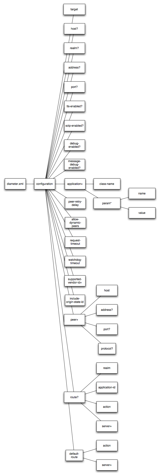

Figure C-1 shows the element hierarchy of the diameter.xml file.
Figure C-1 Element Hierarchy of diameter.xml
