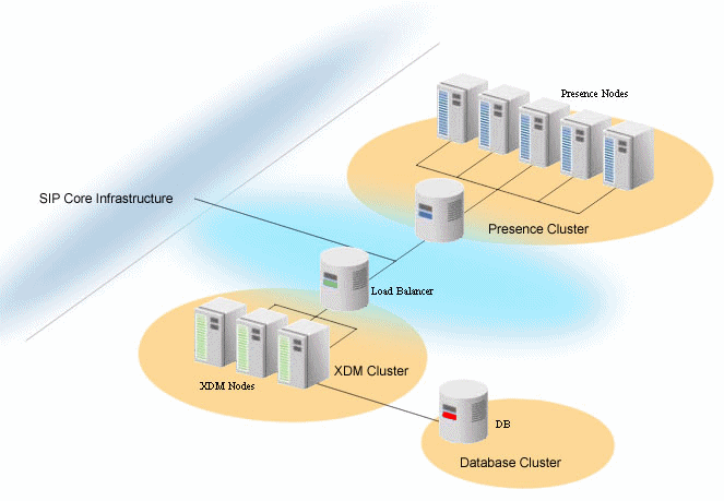

Figure G-1 shows a complete Presence and XDM cluster with all necessary components. This figure also illustrates that the two clusters, Presence and XDM, are treated as two separate clusters and the way into those two networks for initial traffic is always through their respective Load Balancers. Even the Presence Servers will actually go through the Load Balancer of the XDM Cluster when setting up subscriptions. However, once a subscription has been established the subsequent requests will not go through the Load Balancer but rather directly to the XDMS instance hosting the subscription. All nodes in the XDM Cluster are directly accessible from the Presence Cluster.
