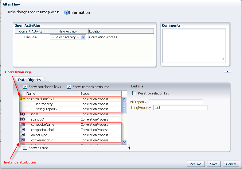

If you select a single process instance, then the Alter Flow dialog box appears as shown in the example in Figure A-1.
Figure A-1 Altering the Flow of a Process Instance
By default, the Alter Flow dialog box shows only the Process and Project data attributes. When you select one of the open activities, it shows the data objects within the context of that open activity. For example, if the open activity is a subprocess, then the Alter Flow dialog box displays any subprocess level data objects.
In the Alter Flow dialog box, you can do any or all of the following:
View the list of current activities in a running process instance in the Open Activities table.You can select the new activity where you want to move the token. Note that the New Activity list includes only those locations to which a token can be moved validly.
Include the correlation keys in the list of data objects as shown in Figure A-1. The correlation keys will be visible only if the process is using correlation. To do this, select Show correlation key. If you select a correlation key, then the details section shows the correlation property that comprises the key. To reset the correlation key, select Reset correlation key.
For information about correlation keys, see Chapter 24, "Communicating Business Processes Using Correlations".
Include process instance attributes in the list of data objects as shown in Figure A-1. To do this, select Show instance attributes. To display the details of a particular instance attribute, select the attribute. Note that only those instance attributes that can be modified appear as editable. Others are read-only.
Add any comments in the Comments field.

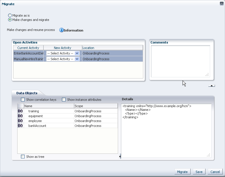

Select one or more process instances. From the Actions list, select Migrate. The Migrate dialog box appears.
The elements in this dialog box change depending on your selection. If you select Migrate as is, only the Comments field is available. If you select a single instance and then select Make changes and migrate, then the Migrate dialog box appears as shown in Figure A-2.
If you select Make changes and migrate, you can do any or all of the following:
In the Open Activities table, you can view the activities where the token is currently running. You can select the new activity where you want to move the token. Note that the New Activity list includes only those locations to which a token can be moved validly
For a pending migration instance to resume, all removed activity tokens need to be moved to new activities.
If you select more than one activity from the Open Activities table, then the Data Objects tab does not appear, and you are not able to modify the payloads.
Include the correlation keys in the list of data objects. To do this, select Show correlation keys, then, in the Data Objects tab, select Show as tree, expand the data object. If you select a correlation key, then the details section shows the correlation property that comprises the key. To reset the correlation key, select Reset.
Include process instance attributes in the list of data objects. To do this, select Show instance attributes, then, in the Data Objects tab, select Show as tree, then expand the data object, then expand Instance Attrtibutes. To display the details of a particular instance attribute, select the attribute. Note that only those instance attributes that can be modified appear as editable. Others are read-only.

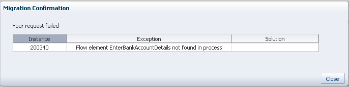

If, for some reason, the migration fails, the Migration Confirmation dialog box tells you why, as shown in Figure A-3.
Figure A-3 Migration Confirmation: Failure Message

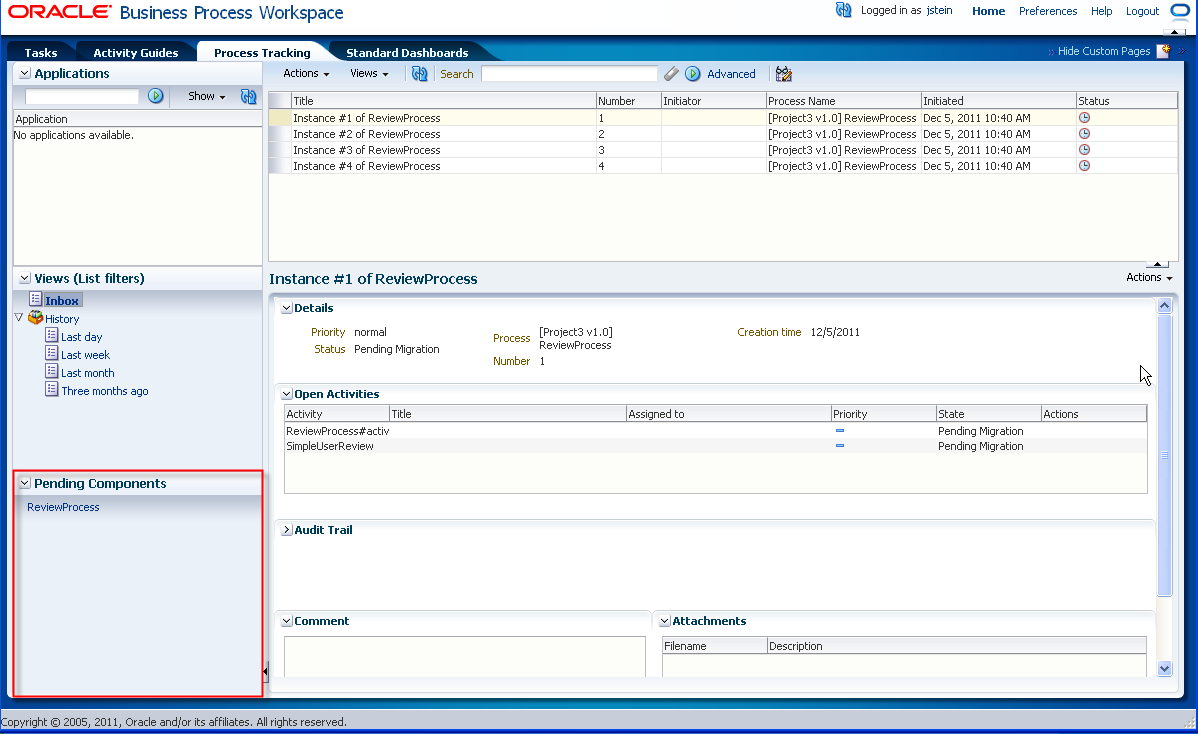

All suspended components are listed in the Pending Components panel, as shown in the example in Figure A-4.
Figure A-4 Pending Components Panel in the Process Tracking Tab Page

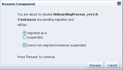

From the Pending Components panel, select the component you want to resume. The Resume Component dialog box appears as shown in the example in Figure A-5. It tells you how many instances are pending migration for that component.
In the Resume Component dialog box, choose whether you want the pending migration process instances to be:
Migrated as is
Suspended
If there are instances that cannot be migrated-as-is, and you want to resume the component, then select Leave non-migrated instances as suspended. If you do not select this option, and there are instances that cannot be migrated as-is, then the component can not be resumed.
Click Resume. The component is resumed and it no longer appears in the Pending Components panel. A Resume Component Confirmation dialog box tells you the result and how many instances are suspended. A new process instance can now be initiated and its requests will be processed.

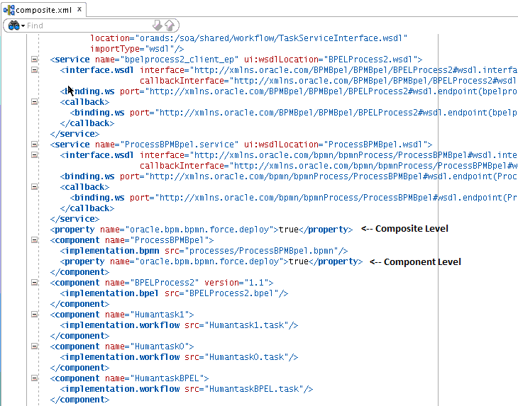

If you do not want redeployment to fail in these scenarios, then you must set the force.deploy
flag manually by editing the composite.xml
file in Oracle JDeveloper. To set force.deploy
at the component level, enter the following:
<component name="T4"> <property name="oracle.bpm.bpmn.force.deploy">true</property> <implementation.bpmn src="processes/T4.bpmn"/> </component>
To set the force.deploy
at the composite level, you can use the same .xml
element as a child of the composite element as shown in the example in Figure A-6.
