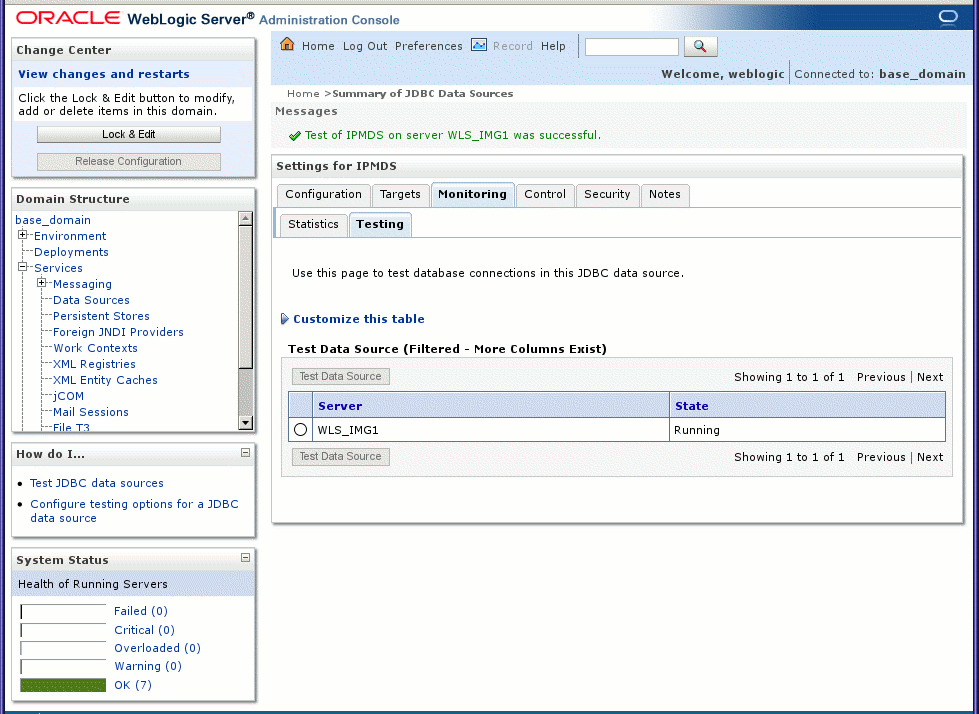

Section 11.6, "Validating GridLink Data Sources for WCC_IMG1"

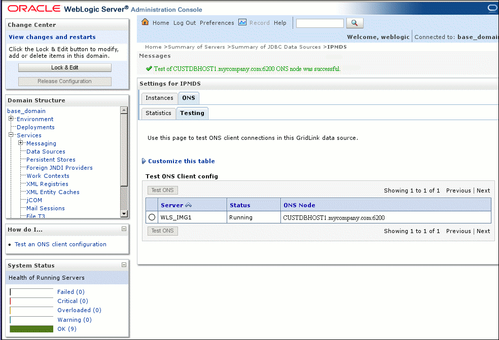

Verify the configuration of GridLink data sources and Oracle Notification Service (ONS) |
Follow these instructions to verify that the configuration of GridLink data sources and ONS is correct. |
Section 11.6, "Validating GridLink Data Sources for WCC_IMG1" |

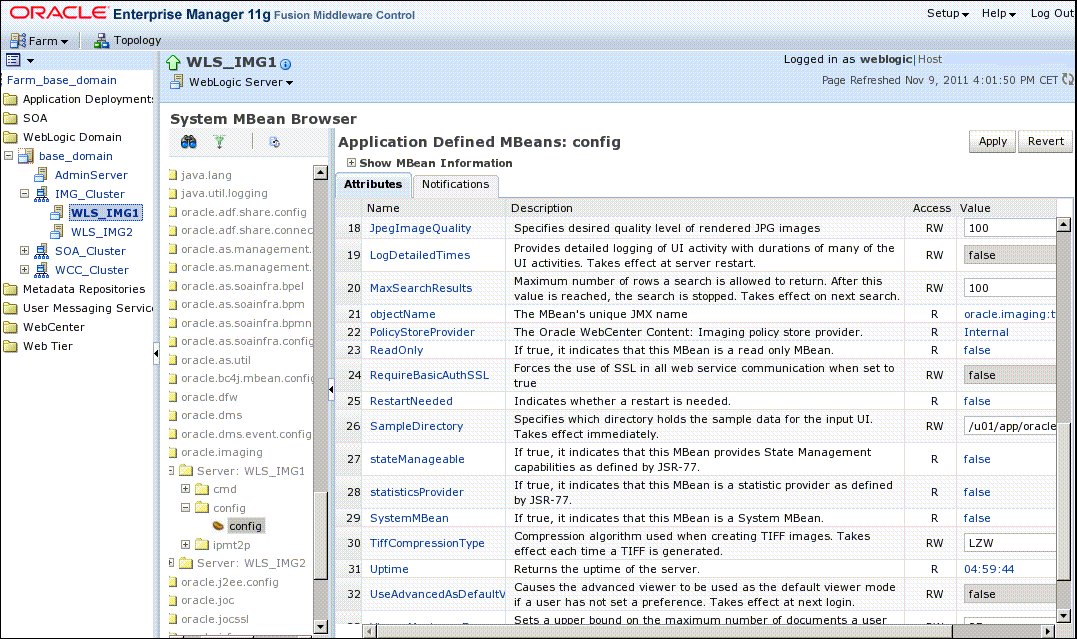

Configure System MBeans for Imaging |
Configure the |
Section 11.13, "Configuring System MBeans for Oracle WebCenter Content: Imaging" |

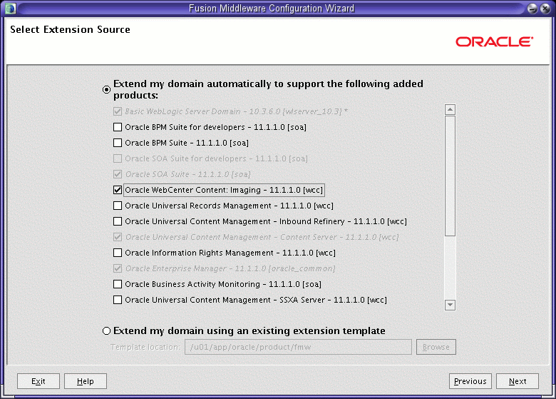

In the Select Extension Source screen (Figure 11-1), make these selections:
Select Extend my domain automatically to support the following added products.
Select this product:
Oracle WebCenter Content: Imaging - 11.1.1.0 [wcc]
The following products should already be selected and grayed out. They were selected when you created the domain (Section 8.3) or extended it for Oracle SOA Suite components (Section 9.3) or WebCenter Content (Section 10.3).
Basic WebLogic Server Domain - 10.3.6.0 [wlserver_10.3]
Oracle SOA Suite for developers - 11.1.1.0 [soa]
Oracle SOA Suite - 11.1.1.0 [soa]
Oracle Universal Content Management - Content Server - 11.1.1.0 [wcc]
Oracle Enterprise Manager - 11.1.1.0 [oracle_common]
Oracle WSM Policy Manager - 11.1.1.0 [oracle_common]
Oracle JRF - 11.1.1.0 [oracle_common]
Figure 11-1 Select Extension Source Screen for Imaging
Click Next.

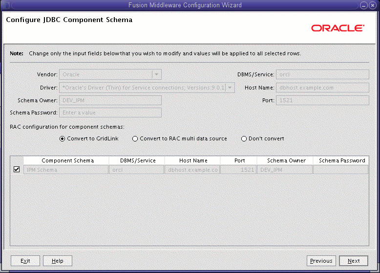

In the Configure JDBC Component Schema screen, which Figure 11-2 shows, do the following:
Select IPM Schema only (for Imaging). Do not select any of the other existing schemas.
For the RAC configuration, you can select Convert to GridLink or Convert to RAC multi data source (described in Appendix A, "Using Multi Data Sources with Oracle RAC"). For the instructions given here, select Convert to GridLink.
After you select a RAC configuration, all selected schemas are grayed.
Figure 11-2 Configure JDBC Component Schema Screen for Imaging
Click Next.

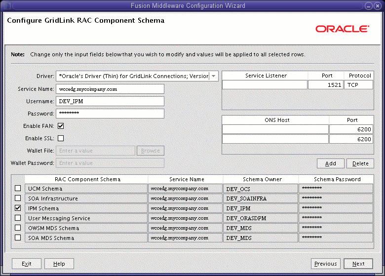

In the Configure GridLink RAC Component Schema screen (Figure 11-3), do the following:
Select IPM Schema (for Imaging). Leave the other data sources as they are.
Figure 11-3 Configure GridLink RAC Component Schema Screen for Imaging
Enter values for the following fields, specifying the connection information for the GridLink RAC database that was seeded through RCU:
Driver: Select Oracle driver (Thin) for GridLinkConnections,Versions:10 and later.
Service Name: Enter the service name of the Oracle RAC database in lowercase letters, followed by the domain name; for example, wccedg.mycompany.com.
Username: Enter the complete user name for the database schema owner of the corresponding component.
This book uses DEV as the prefix of user names for the database schemas.
Password: Enter the password for the database schema owner.
Select Enable FAN.
Enable SSL: Leave this option deselected.
If you select SSL to enable Oracle Notification Service (ONS) notification encryption, provide the appropriate Wallet File and Wallet Password details.
Service listener: Enter the Oracle Single Client Access Name (SCAN) address and port for the Oracle RAC database being used. The protocol should be TCP.
Oracle recommends that you use a SCAN address to specify the Service Listener (and OSN Host) so you do not need to update a GridLink data source containing a SCAN address if you add or remove Oracle RAC nodes. To determine the SCAN address, query the remote_listener parameter in the database:
SQL>show parameter remote_listener; NAME TYPE VALUE ----- ------ ------- remote_listener string db-scan.mycompany.com :1521
For Oracle Database 11g Release 1 (11.1), use the virtual IP and port of each database instance listener; for example:
custdbhost1-vip.mycompany.com (port 1521)
and
custdbhost2-vip.mycompany.com (1521)
For Oracle Database 10g, use multi data sources to connect to an Oracle RAC database. For information about configuring multi data sources, see Appendix A, "Using Multi Data Sources with Oracle RAC."
ONS Host: Enter here also the SCAN address for the RAC database and the ONS remote port, as reported by the database:
[orcl@CUSTDBHOST1 ~]$ srvctl config nodeapps -s ONS exists: Local port 6100, remote port 6200, EM port 2016
For Oracle Database 11g Release 1 (11.1), use the hostname and port of each database's ONS service; for example:
custdbhost1.mycompany.com (port 6200)
and
custdbhost2.mycompany.com (6200)
Click Next.

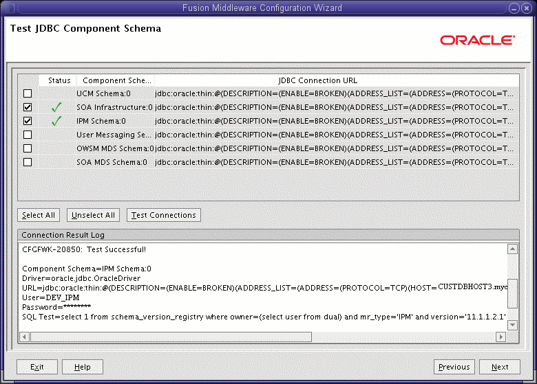

In the Test JDBC Component Schema screen, select the IPM Schema row, then click Test Connections.
The Connection Results Log displays the results. Ensure that the connection to the database that contains the schema was successful. If not, click Previous to return to the previous screen, correct your entry, and then retry the test.
Click Next when the connection is successful.

Before you propagate the domain configuration to WCCHOST2, verify that every GridLink data source you created is correctly configured and that the Oracle Notification Service (ONS) setup is correct for each data source on each managed server.
To verify the configuration of a GridLink data source for Imaging:
Log in to the WebLogic Server Administration Console.
In the Domain Structure tree, expand Services, then click Data Sources.
Click the name of a GridLink data source that was created.
Click the Monitoring tab, and click the name of one of the servers.
Click the Testing tab (Figure 11-5), select one of the servers, and click Test Data Source.
Figure 11-5 Testing a GridLink Data Source for Imaging
The test should be successful if the configuration is correct.
Repeat the test for every WebLogic Server instance that uses the GridLink data source.
To verify the configuration of ONS for a GridLink data source for Imaging:
Click the name of a GridLink data source.
Click the ONS tab and then the Testing tab (Figure 11-6).
Select a server, and click Test ONS.
Figure 11-6 Testing the ONS Configuration for Imaging
The test should be successful if the configuration is correct. If the ONS test fails, verify that the ONS service is running in the Oracle RAC database nodes:
[orcl@CUSTDBHOST1 ~]$ srvctl status scan_listener SCAN Listener LISTENER_SCAN1 is enabled SCAN listener LISTENER_SCAN1 is running on node CUSTDBHOST1 SCAN Listener LISTENER_SCAN2 is enabled SCAN listener LISTENER_SCAN2 is running on node CUSTDBHOST2 SCAN Listener LISTENER_SCAN3 is enabled SCAN listener LISTENER_SCAN3 is running on node CUSTDBHOST2 [orcl@CUSTDBHOST1 ~]$ srvctl config nodeapps -s ONS exists: Local port 6100, remote port 6200, EM port 2016 [orcl@CUSTDBHOST1 ~]$ srvctl status nodeapps | grep ONS ONS is enabled ONS daemon is running on node: CUSTDBHOST1 ONS daemon is running on node: CUSTDBHOST2
Repeat the ONS test for every WebLogic Server instance that uses the GridLink data source.

To configure the following system MBeans for Oracle WebCenter Content: Imaging:
InputDirectories
SampleDirectory
GDFontPath
Log in to Oracle Fusion Middleware Control at http://ADMINVHN:7001/em (Figure 11-7).
In the left pane, expand the farm domain name, then expand WebLogic Domain, then the domain name, then IMG_Cluster, and then click the WLS_IMG1 link.
At the top of the right-hand panes, click the WebLogic Server drop-down menu and choose System MBean Browser.
Expand Application Defined MBeans and then oracle.imaging.
Expand Server: WLS_IMG1 and then config.
Click the config bean link.
In the right pane, set the InputDirectories MBean to specify the path to the input files: ORACLE_BASE/admin/domain_name/img_cluster_name/input_files.
Please note that all Oracle WebCenter Content servers involved must be able to resolve this location (that is, via the NFS mount point).
Set the SampleDirectory MBean: ORACLE_BASE/admin/domain_name/img_cluster_name/input_files/Samples.
To process input files, the input agent must have the appropriate permissions for the input directory, and the input directory must allow file locking. The input agent requires that the user account that is running the WebLogic Server service have read and write privileges for the input directory and for all files and subdirectories in the input directory. These privileges are required so that the input agent can move the files to the various directories as it works on them. File locking on the share is needed by the input agent to coordinate actions between servers in the cluster.
Set the GDFontPath MBean to specify the path to the GD fonts for the X Windows environment. Check with your system administrator. The default is likely /usr/share/X11/fonts/TTF or /usr/lib/X11/fonts/TTF.
Click Apply.
