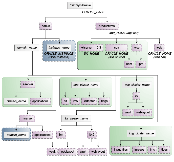

Based on the previous assumptions, the following paragraphs describe the recommended directories. Wherever a shared storage location is directly specified, it is implied that shared storage is required for that directory. When using local disk or shared storage is optional, the mount specification is qualified with "if using a shared disk." The shared storage locations are examples and can be changed as long as the provided mount points are used. Oracle recommends this structure in the shared storage device for consistency and simplicity.
/u01/app/oracle
ORACLE_BASE/product/fmw
Mount point: ORACLE_BASE/product/fmw
Shared storage location: ORACLE_BASE/product/fmw (VOL1 and VOL2)
Mounted from: Nodes alternatively mount VOL1 or VOL2 in such a way that at least half of the nodes use an installation and the other half use the other one. In the Oracle WebCenter Content enterprise deployment, SOAHOST1 and WCCHOST1 mount VOL1 and SOAHOST2 and WCCHOST2 mount VOL2. When only one volume is available, nodes mount two different directories in shared storage alternatively (that is, for example, SOAHOST1 would use ORACLE_BASE/product/fmw1 as a shared storage location and SOAHOST2 would use ORACLE_BASE/product/fmw2 as a shared storage location).
When there is just one volume available in the shared storage, you can provide redundancy using different directories to protect from accidental file deletions and for patching purposes. Two MW_HOMEs would be available; at least one at ORACLE_BASE/product/fmw1, and another at ORACLE_BASE/product/fmw2. These MW_HOMEs are mounted on the same mount point in all nodes.
ORACLE_BASE/product/fmw/web
Mounted from: For shared storage installations, nodes alternatively mount VOL1 or VOL2 in such a way that at least half of the nodes use an installation and the other half use the other one. In the WebCenter Content enterprise deployment, WEBHOST1 would mount VOL1 and WEBHOST2 would mount VOL2. When only one volume is available, nodes mount the two suggested directories in shared storage alternatively (that is, WEBHOST1 would use ORACLE_BASE/product/fmw1 as a shared storage location and WEBHOST2 would use ORACLE_BASE/product/fmw2 as a shared storage location).
Web tier installation is usually performed on storage local to the WEBHOST nodes. When using shared storage, appropriate security restrictions for access to the storage device across tiers need to be considered.
MW_HOME/wlserver_10.3
MW_HOME/soa or MW_HOME/wcc
MW_HOME/oracle_common
ORACLE_INSTANCE (OHS instance):
ORACLE_BASE/admin/instance_name
If you are using a shared disk, the mount point on the machine is ORACLE_BASE/admin/instance_name mounted to ORACLE_BASE/admin/instance_name (VOL1).
(VOL1) is optional; you could also use (VOL2).
Domain Directory for Administration Server Domain Directory:
ORACLE_BASE/admin/domain_name/aserver/domain_name (The last domain_name directory is added by Fusion Middleware Configuration Wizard)
Mount point on machine: ORACLE_BASE/admin/domain_name/aserver
Shared storage location: ORACLE_BASE/admin/domain_name/aserver
Mounted from: Only the node where the Administration Server is running needs to mount this directory. When the Administration Server is relocated (failed over) to a different node, the node then mounts the same shared storage location on the same mount point. The remaining nodes in the topology do not need to mount this location.
Domain Directory for Managed Server Directory:
ORACLE_BASE/admin/domain_name/mserver/domain_name
If you are using a shared disk, the mount point on the machine is ORACLE_BASE/admin/domain_name/mserver mounted to ORACLE_BASE/admin /domain_name/Noden/mserver/ (each node uses a different domain directory for managed servers).
This procedure is really dependent on shared storage. The preceding example is specific to NAS, but other storage types may provide this redundancy with different types of mappings.
Location of JMS file-based stores and Tlogs:
ORACLE_BASE/admin/domain_name/cluster_name/jms
ORACLE_BASE/admin/domain_name/cluster_name/tlogs
Mount point: ORACLE_BASE/admin/domain_name/cluster_name
Shared storage location: ORACLE_BASE/admin/domain_name/cluster_name
Mounted from: All nodes running Oracle SOA Suite and Oracle WebCenter Content components need to mount this shared storage location so that transaction logs and JMS stores are available when server migration to another node take place.
Location of Oracle WebCenter Content: Imaging input files, images, and samples input directories:
ORACLE_BASE/admin/domain_name/img_cluster_name/input_files
ORACLE_BASE/admin/domain_name/img_cluster_name/input_files/Samples
ORACLE_BASE/admin/domain_name/img_cluster_name/images
Mount point: ORACLE_BASE/admin/domain_name/img_cluster_name
Shared storage location: ORACLE_BASE/admin/domain_name/img_cluster_name
Mounted from: All nodes containing Imaging mount these locations (all nodes need to have access to input files and the images to process).
The location of input files and images may vary according to each customer's implementation needs. It is relevant, however, that image files are located in a device isolated from other concurrent accesses that can degrade the performance of the system. A separate volume can be used for this purpose. In general, it is good practice to place the files under the cluster directory structure for consistent backups and maintenance.
In a multinode Imaging installation, this location is shared among all the input agents and must be accessible by all agents. If input agents are on different machines, this must be a shared network.
In order to process input files, the input agent must have the appropriate permissions on the input directory and the input directory must allow file locking. The input agent requires that the user account that is running the WebLogic Server service have read and write privileges to the input directory and all files and subdirectories in the input directory. These privileges are required so that the input agent can move the files to the various directories as it works on them. File locking on the share is needed by the input agent to coordinate actions between servers in the cluster.
Location of the Oracle WebCenter Content vault (native file repository):
ORACLE_BASE/admin/domain_name/wcc_cluster_name/cs/vault
Mount point: ORACLE_BASE/admin/domain_name/wcc_cluster_name
Shared storage location: ORACLE_BASE/admin/domain_name/wcc_cluster_name
Mounted from: All nodes that contain WebCenter Content mount this location (all nodes need to have access to input files and the images to process).
Location of the Inbound Refinery directory:
ORACLE_BASE/admin/domain_name/ibr_cluster_name
ORACLE_BASE/admin/domain_name/ibr_cluster_name/ibrN (where N is the number of an Inbound Refinery instance)
Mount point: ORACLE_BASE/admin/domain_name/ibr_cluster_name
Shared storage location: ORACLE_BASE/admin/domain_name/ibr_cluster_name
Mounted from: All nodes that contain Inbound Refinery mount this location.
Location of the application directory for the Administration Server:
ORACLE_BASE/admin/domain_name/aserver/applications
Mount point: ORACLE_BASE/admin/domain_name/aserver/applications
Location of the application directory for a managed server:
ORACLE_BASE/admin/domain_name/mserver/applications
This directory is local in the context of the Oracle WebCenter Content enterprise deployment. A shared domain directory for a managed server with Content Server does not work because certain files within the domain, such as intradoc.cfg, are specific to each node.
Figure 4-1 shows this directory structure in a diagram.
Figure 4-1 Enterprise Deployment Directory Structure for Oracle WebCenter Content
The directory structure in Figure 4-1 does not show other required internal directories, such as oracle_common and jrockit.
Table 4-1 explains what the various color-coded elements in Figure 4-1 mean.
Table 4-1 Directory Structure Elements
| Element | Explanation |
The Administration Server domain directories, applications, deployment plans, file adapter control directory, JMS and TX logs, and the entire MW_HOME are on a shared disk. |
The managed server domain directories can be on a local disk or a shared disk. Further, if you want to share the managed server domain directories on multiple nodes, then you must mount the same shared disk location across the nodes. The instance_name directory for the web tier can be on a local disk or a shared disk. |
Fixed name. |
Installation-dependent name. |

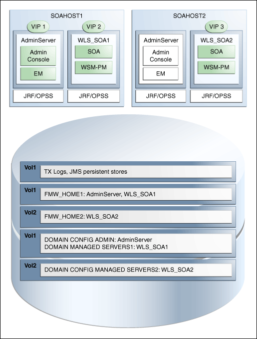

Figure 4-2 shows an example configuration for shared storage with multiple volumes for Oracle SOA Suite.
Figure 4-2 Example Configuration for Shared Storage
Table 4-2 summarizes the directory structure for an Oracle WebLogic Server domain that includes Oracle SOA Suite and Oracle WebCenter Content managed servers that share storage.
Table 4-2 Contents of Shared Storage
| Server | Type of Data | Volume in Shared Storage | Directory | Files |

VOL3 is mounted as an NFS nolock volume. For details, see Section 4.4, "Configuring Shared Storage".
Use the following commands to create and mount shared storage locations so that WCCHOST1 and WCCHOST2 can see the same location for binary installation in two separate volumes.
The user ID used to create a shared storage file system owns those files and has read, write, and execute privileges for them. Other users in the operating system group can read and execute the files, but they do not have write privileges. For more information about installation and configuration privileges, see the "Understanding Installation and Configuration Privileges and Users" section in the Oracle Fusion Middleware Installation Planning Guide.
In the commands, nasfiler is the shared storage filer.
From SOAHOST1 and from WCCHOST1:
mount nasfiler:/vol/vol1/ORACLE_BASE/product/fmw ORACLE_BASE/product/fmw -t nfs
From SOAHOST2 and from WCCHOST2:
mount nasfiler:/vol/vol2/ORACLE_BASE/product/fmw ORACLE_BASE/product/fmw -t nfs
If only one volume is available, you can provide redundancy for the binaries by using two different directories in the shared storage and mounting them to the same directory in the Oracle WebCenter Content servers:
mount nasfiler:/vol/vol1/ORACLE_BASE/product/fmw1 ORACLE_BASE/product/fmw -t nfs
mount nasfiler:/vol/vol1/ORACLE_BASE/product/fmw2 ORACLE_BASE/product/fmw -t nfs
The following commands show how to share the Oracle WebCenter Content TX logs location across different nodes:
From WCCHOST1:
mount nasfiler:/vol/vol1/ORACLE_BASE/admin/domain_name/wcc_cluster_name/tlogs ORACLE_BASE/admin/domain_name/wcc_cluster_name/tlogs -t nfs
From WCCHOST2:
The following commands show how to share the Imaging jms location across different nodes:
From WCCHOST1:
mount nasfiler:/vol/vol1/ORACLE_BASE/admin/domain_name/img_cluster_name/jms ORACLE_BASE/admin/domain_name/img_cluster_name/jms -t nfs
From WCCHOST2:
The following commands show how to share WebCenter Content and Inbound Refinery files across different nodes:
WCPAHOST1> mount nasfiler:/vol/vol3/ORACLE_BASE/admin/wcdomain/wcc_cluster_name/vault -t nfs -o rw,bg,hard,vers=3,nolock WCPHOST1> mount nasfiler:/vol/vol3/ORACLE_BASE/admin/wcdomain/ibr_cluster_name/ nfs -o rw,bg,hard,vers=3,nolock
And likewise for WCPHOST2.
