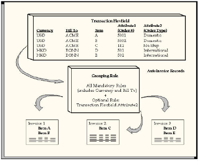

This example illustrates how to use grouping rules to group transaction lines into transactions during AutoInvoice import.
Define an AutoInvoice grouping rule that specifies that to appear on the same invoice, items must match on all mandatory attributes, such as currency (CURRENCY_CODE) and customer bill-to address (ORIG_SYSTEM_BILL_ADDRESS_ID), and must also match on the optional attribute of sales order type (SALES_ORDER_SOURCE).
During AutoInvoice import, assume that all mandatory attributes match other than currency and customer bill-to address.
This diagram illustrates how three imported invoices are created according to the AutoInvoice grouping rule defined in this example:
Items A and B share the same currency and sales order type, so they appear on the same invoice (Invoice 1). Item C has the same currency as A and B, but it has a different sales order type, so it appears on its own invoice (Invoice 2). Items D and E share the same currency and sales order type, so they appear on the same invoice (Invoice 3).
Because of the optional attribute of sales order type, AutoInvoice created three invoices. If the grouping rule had designated only mandatory attributes, then AutoInvoice would have created only two invoices.

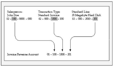

These two scenarios illustrate how Receivables uses the AutoAccounting structure you define to determine your Accounting Flexfield defaults.
You want to define a four segment Revenue Flexfield: 00-000-0000-000 (Company-Cost Center-Account-Product). You can define AutoAccounting to derive defaults for each segment:
Company, the first segment, is the constant 01.
Cost Center, the second segment, derives from the salesperson (John Doe).
Account, the third segment, derives from the transaction type (Standard Invoice).
Product, the fourth segment, derives from the standard line (20 Megabyte Hard Disk).
Salesperson John Doe enters a one line Standard Type invoice for a 20 Megabyte Hard Drive.
This graphic illustrates how AutoAccounting derives the Revenue Flexfield based on a separate definition for each segment:

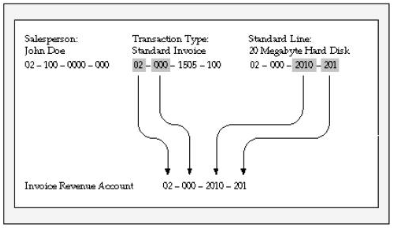

You redefine the structure so that AutoAccounting only uses information from the transaction type (Standard Invoice) for segments 1 and 2, and standard line (consulting services) for segments 3 and 4.
This graphic illustrates how AutoAccounting derives the Revenue Flexfield based on the same definitions for segments 1 and 2 and segments 3 and 4:
