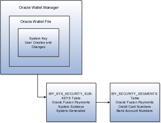

When you enable encryption in Payments, you create one system-level security key, which is a 168 bit 3-DES key. The system key is the encryption master key for the entire installation. It is stored in an Oracle Wallet file and is used to encrypt Payments system subkeys. The Encryption feature enables you to rotate the system key. System key rotation changes the subkey data, but does not result in a re-encryption of the credit card numbers or bank account numbers. To secure your payment instrument data, your security policy should include a regular schedule to rotate the system keys.
The security architecture for credit card data encryption and bank account data encryption is comprised of the following components:
Oracle Wallet Manger
Oracle Wallet file
System key
System subkeys
Credit card number storage
Bank account number storage
For payment instrument encryption, Payments uses a chained key approach. To simplify, the chained key approach is used for data security where A encrypts B and B encrypts C. In Payments, the system key encrypts the subkeys and the subkeys encrypt the payment instrument data. This approach allows easier rotation of the system key. The system key is the encryption master key for the entire installation. It is stored in a wallet file and is used to encrypt Payments subkeys.
Before encryption can be enabled for the first time, a wallet file must already exist on the file system of the Enterprise Storage Server (ESS). You must either create an empty wallet file called ewallet.p12 and, if you would like to use your own system-level encryption key, a file called key.bits containing your binary (3DES) encryption key or use the automatic wallet creation feature that automatically creates the empty wallet for you. Both files should be placed in the same directory, and the directory must be readable and writable by the Weblogic Server (WLS) container hosting the Financials Domain. The automatic wallet creation feature ensures that the wallet file is created in the proper location and with all necessary permissions.
When creating a wallet on the Manage System Security page, the full path of ewallet.p12 should be entered in the New Wallet File Location field, and if you are using a user-defined key, the full path of key.bits should be entered in the Key File Location field. No file path information is needed when using the automatic wallet creation feature.
