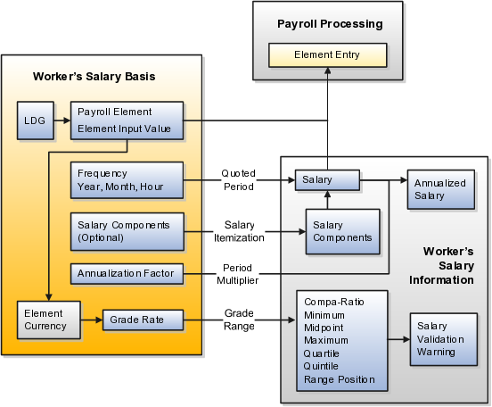

The salary basis specifies the frequency of the amount sent to payroll and stored as salary, such as annual or hourly amount. It also specifies the payroll element and input value that feeds the salary to payroll as well as the grade rate that provides the salary range for metrics and salary validation.
This figure shows how the data on a worker's salary basis contributes to salary information and payroll processing.
The legislative data group (LDG) restricts the payroll elements available to associate with the salary basis.
The salary basis holds the payroll element for base pay. When you define a base pay payroll element, you specify an input value that holds base pay on a worker's element entry.
For base pay salary the input value is Amount.
For hourly wages the input value is Rate.
When you enter or update a base pay amount for a worker, the application creates or updates the base pay element entry for that person. The monetary amount or rate recorded in the element entry is the salary value in the worker's salary information that is held on the assignment or employment terms.
For example:
If the salary basis frequency is Annually, the amount passed to the element entry is an annual amount.
If the salary basis frequency is Hourly, the amount of the element entry is the hourly rate.
The payroll run detects and processes the element entry for the worker in the current payroll period. The element's formula:
Converts the input value amount on the element entry to the appropriate payroll period amount
Multiplies the input value hourly rate by the number of hours reported for the payroll period
The resulting base pay earnings appear on the payslip for the payroll element associated with the salary basis.
