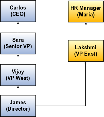

The hierarchy determines how approvals are routed to the highest level approver. The same hierarchy also determines how budgets are pushed down the organization when using manager level budgeting, or how budgets roll up when using worker level budgeting. It also determines the workers that appear on each manager's worksheet. Determine the hierarchy by one of the three options:
Approvals management structure
Manager hierarchy
Formula
A set of approval relationships and rules used by the Approvals Management Structure determines the hierarchy.
The supervisor associated with the worker's employment record determines the hierarchy.
A custom hierarchy created using a formula determines the hierarchy.
The Compensation Hierarchy Determination formula determines the hierarchy for an associated workforce compensation plan.
You select the formula on the Configure Plan Details page.

James reports officially to Vijay. However, James' entire team did a special project for Lakshmi most of the past year. Sara wants Lakshmi to review and approve the compensation for James' team. Sara wants to approve the worksheet after Lakshmi is finished.
Here is how you build the alternate approver table:
Worksheet Manager |
Approval Sequence |
Alternate Approver |
Carlos |
4 |
Maria |
Sara |
3 |
Carlos |
Lakshmi |
2 |
Sara |
James |
1 |
Lakshmi |
This figure shows that, after Lakshmi approves James' worksheet, the worksheet returns to the plan hierarchy approval flow.

An alternate approver is a person defined as an approver of a worksheet. The person may not be part of the standard hierarchy or may be in a different position than in the standard approval hierarchy. The standard approval hierarchy is built using the hierarchy type defined for the plan.
Yes. You can change the hierarchy of an already defined alternate approver without running the refresh process. But, if you want to add an alternate approver for a new person or delete one for an existing person after the start compensation cycle process has run, then you must refresh the data.
