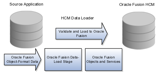

The following figure shows an overview of the data-load process.
HCM Data Loader
To use the HCM Data Loader, you:
  1. Map data between your source application and Oracle Fusion HCM.
  2. Extract data from your source application and place it in the HCM Data Loader staging tables in the supported Oracle Fusion HCM object-data format.
  3. Run the Load Batch Data process to load the data into Oracle Fusion HCM.

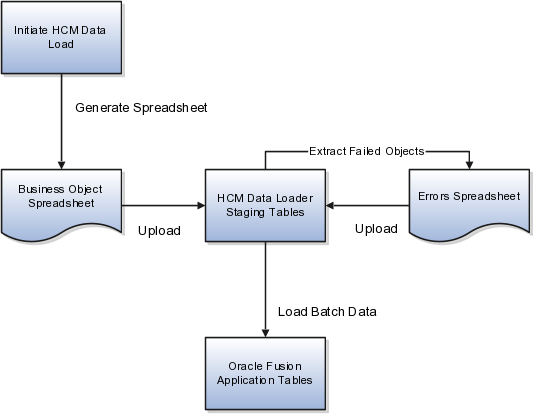

Uploading Data Using HCM Spreadsheet Data Loader: Explained
HCM Spreadsheet Data Loader enables you to upload business objects to Oracle Fusion Human Capital Management (HCM) from a spreadsheet. Business objects that you can upload include person and assignment data, grades, jobs, benefit plan types, content items, performance templates, and rating models. You can view the complete list of supported business objects on the Initiate Data Load page, where objects appear in the recommended load order.
This topic describes:
How Data Is Uploaded Using HCM Spreadsheet Data Loader
Uploading business objects using HCM Spreadsheet Data Loader is a two-stage process. You:
  1. Generate a spreadsheet for a single HCM business object, enter data in the spreadsheet, and upload the data to a named batch in the HCM Data Loader staging tables.
    HCM Data Loader is a generic process for loading data to Oracle Fusion HCM from external sources.
  2. Run the Load Batch Data process to transfer data from the HCM Data Loader staging tables to the Oracle Fusion application tables.
The following figure, which also shows one approach to error correction, summarizes both stages of this process.
The HCM Spreadsheet Data Loader
Correcting Upload Errors
When you upload data from a spreadsheet to a batch in the HCM Data Loader staging tables, the status of each spreadsheet row is updated to show whether the row was inserted successfully in the batch. If the row insertion fails, you can double-click the status value to display information about the error. After correcting the error, you upload the corrected data to the existing batch.
Correcting Load Batch Data Errors
When you run Load Batch Data to transfer data from the HCM Data Loader staging tables to the Oracle Fusion application tables, the data is validated.
If errors occur, you can:

Upload the position data by:
  1. Selecting the Initiate HCM Spreadsheet Load task
  2. Creating the positions spreadsheet
  3. Entering data in the positions spreadsheet
  4. Uploading positions data to the HCM Data Loader staging tables
  5. Loading positions data to the application tables from the HCM Data Loader staging tables
  6. Reviewing the results of the Load Batch Data process and correcting errors

Reviewing the Results of the Load Batch Data Process and Correcting Errors
  1. On the Load Batch Data page, search again for the batch SalesPositions113012Batch01 and review its status in the Batch Status column of the Search Results region.
  2. If the batch status is Complete, click Done to close the Load Batch Data page; otherwise, continue with the next step.
  3. If the batch completed with errors, select the batch in the Search Results.
  4. On the Batch Summary tab of the Batch Details region, select Action - Extract Failed Objects to Spreadsheet.
    An errors spreadsheet is created automatically.
  5. Save the errors spreadsheet locally as SalesPositions113012Batch01Errors01.xlsx.
  6. Leave the batch name in the errors spreadsheet as SalesPositions113012Batch01.
  7. Review the error messages in the spreadsheet and correct the errors.
  8. Repeat this process from the section Uploading Positions to the HCM Data Loader Staging Tables until all errors are fixed.
    If further errors occur, increment the errors-spreadsheet suffix by 1 (for example, SalesPositions113012Batch01Errors02, SalesPositions113012Batch01Errors03, and so on.)

How can I fix HCM Spreadsheet Data Loader errors?
Errors may occur when you run the Load Batch Data process to transfer data from the HCM Data Loader staging tables to the Oracle Fusion application tables. You can fix these errors in the staging tables by navigating to the object detail from the Total Objects column (click the number of objects) on the Failed tab in the Details section of the Load Batch Data page. This approach may be suitable if there are few errors or you do not need to correct the source data.
Alternatively, you can download error rows from the HCM Data Loader staging tables to a spreadsheet by selecting Action - Extract Failed Objects to Spreadsheet on the Batch Summary tab of the Details region on the Load Batch Data page. In this case, a spreadsheet containing the rows in error is generated automatically. After fixing the errors in the spreadsheet, you upload the corrected data to the staging tables and run Load Batch Data again. This solution is available only for data initially uploaded using HCM Spreadsheet Loader.
