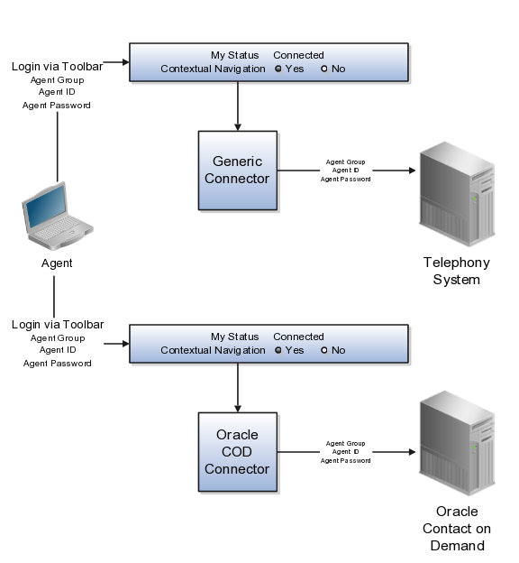

An Agent is required to sign in to a connector to establish the connection to the telephony system to make and receive calls. This task establishes the relationship between the connector, the agent, the agent group, identifier and password.
After adding a new row to the connector settings,
you can search for the agent name using the orange glyph that opens
a search dialog. The assignment of the agent groups, an agent ID,
and password are usually defined and entered by the administrator.
An agent can also self-provision themselves through the agent sign
in dialog box. This dialog box is not available through the setup
UI. It can be launched in the transaction flow from the toolbar UI.
On the sign in dialog box, click on edit connector. User can then
create a connector for himself and also provide additional agent parameters
for the connector. These data values are used exclusively for an agent
signing in to a connector. There is also a sub-page for entering any
other parameters specific to that agent that are required by the third
party telephony system and not covered in the delivered configuration
parameters. Some examples required for Oracle Contact On Demand Connector
are the AcdUserID and AcdExtension. These two parameters are used in the agent
transfer scenario where a list of agents together with the Extension
will be available for the user to choose to which agent the call will
be transferred. AcdUserId is a special
id that Oracle Contact On Demand (COD) assigns to each COD user. AcdExtension is the virtual extension that COD
assigns to each user. Therefore, instead of knowing the exact number
to dial in order to reach out to an agent, the extension can be used.
COD determines the phone number to call from that virtual extension.
The agent connector parameters will differ from one connector to another.

An agent initiates their availability for inbound voice communications by signing in to a connector via the tool bar. The agent signs in via a single connector for that toolbar session. Each connector is associated with an agent or agents. The agent has an assigned agent group, agent identifier and password for each connector. This enables the Agent to sign on to a connector and use the tool bar to receive and transfer calls to other agents and customers or contacts. There may also be other parameters required at this agent level for the telephony system. These can be designated at the agent connector parameter level and passed by the connector to the telephony system. Agents may also record each of these transactions via the Oracle Fusion Interaction features.
Connectors perform the linking of the agent to the telephony system that enables the outgoing and incoming calls via Click-to-Dial. The Oracle Contact on Demand Connector is delivered. Contact On Demand is a multichannel, all-in-one call center application that itself connects to the Public Switched Telephony Network (PSTN) to provide voice communication capability. Other connectors may be added using the delivered template.
