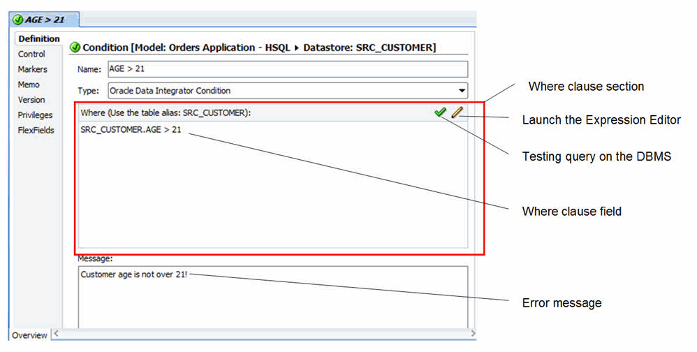

In the Definition tab of the Condition Editor:
In the Name field, enter the name of your condition. For example: AGE > 21.
From the Type list, select Oracle Data Integrator Condition.
In the Where clause field, enter the following SQL code:
SRC_CUSTOMER.AGE > 21
Notes:
You can enter this text directly in the Where clause field or you can use the Expression Editor. To open the Expression Editor click Launch the Expression Editor in the Where clause toolbar menu.
The constraints created by Oracle Data Integrator are not actually created on the database. The constraints are stored in the Repository.
In the Message field, specify the error message as it will appear in your error table:
Customer age is not over 21!
Figure 5-2 shows the Condition Editor.
From the File main menu, select Save to save the condition.

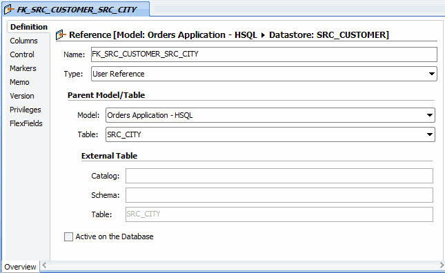

This section describes how to create a reference constraint based on the CITY_ID column between the SRC_CUSTOMER table and the SRC_CITY table.
This constraint allows checking that customers are located in a city that exists in the SRC_CITY table.
To create the reference constraint:
In the Models accordion in Designer Navigator, expand the Orders Application - HSQL model.
Expand the SRC_CUSTOMER datastore.
Right-click the Constraints node and select New Reference as shown in Figure 5-3.
In the Definition tab of the Reference Editor:
From the Type list, select User Reference.
From the Model list in the Parent Model/Table section, select Orders Application - HSQL. This is the data model containing the table you want to link to.
From the Table list, select SRC_CITY. This is the table you want to link to.
Figure 5-4 shows the Reference Editor.

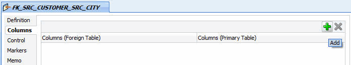

In the Reference Editor, go to the Columns tab.
On the Columns tab, click Add as shown in Figure 5-5.
A new row is inserted in the columns table.

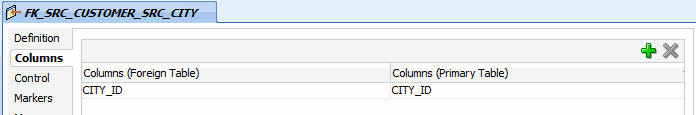

In this step you define the matching columns:
Click on the row that appears. This will bring up a drop-down list containing all of the columns in the appropriate table.
From the Columns (Foreign Table) list, select CITY_ID.
From the Columns (Primary Table) list, select CITY_ID.
Figure 5-6 shows the Columns tab of the Reference Editor with the selected matching columns.
Note that in this example the Foreign Table is SRC_CUSTOMER and the Primary Table is SRC_CITY. Note also that it is not required for foreign keys that the column names of the Foreign Table and the Primary Table match. It just happens that they do in this example.
Select File > Save to save this reference.

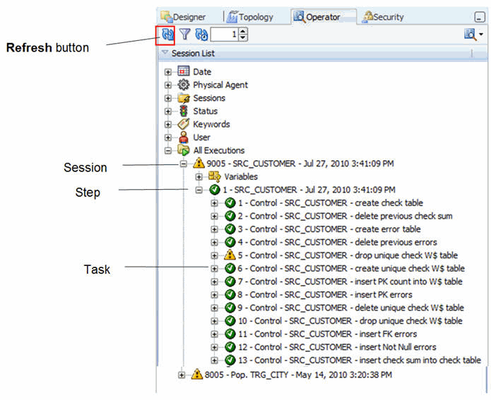

Through Operator Navigator, you can view your execution results and manage your development executions in the sessions.
To view the execution results of your control:
In the Session List accordion in Operator Navigator, expand the All Executions node.
The Session List displays all sessions organized per date, physical agent, status, keywords, and so forth.
Refresh the displayed information clicking Refresh in the Operator Navigator toolbar.
The log for one execution session appears as shown in Figure 5-9.
The log comprises 3 levels:
The session (corresponds to an execution of a scenario, an interface, a package or a procedure undertaken by an execution agent)
The step (corresponds to a checked datastore, an interface, a procedure or a step in a package or in a scenario)
The task (corresponds to an elementary task of the interface, process or check)

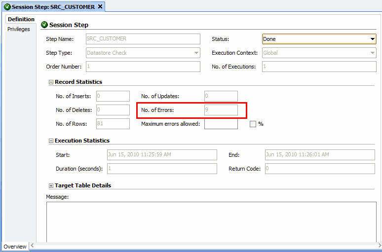

To determine the number of invalid records:
In the Session List accordion in Operator Navigator, expand the All Executions node and the SRC_CUSTOMER session.
Double-click the SRC_CUSTOMER step to open the Session Step Editor.
The Record Statistics section details the changes performed during the static control. These changes include the number of inserts, updates, deletes, errors, and the total number of rows handled during this step.
Figure 5-10 shows the Session Step Editor of the SRC_CUSTOMER step.
The number of invalid records is listed in the No. of Errors field. Note that the static control of the SRC_CUSTOMER table has revealed 9 invalid records. These records have been isolated in an error table. See Section 5.2.6.2, "Reviewing the Invalid Records" for more information.

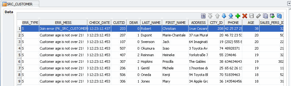

You can access the invalid records by right-clicking on the table in your model and selecting Control > Errors...
To review the error table of the static control on the SRC_CUSTOMER table:
In Designer Navigator, expand the Orders Application - HSQL model.
Right-click the SRC_CUSTOMER datastore.
Select Control > Errors...
The Error Table Editor is displayed as shown in Figure 5-11.
The records that were rejected by the check process are the following:
8 records in violation of the AGE > 21 constraint (the actual age of the customer is 21 or younger, see the AGE column for details).
1 record in violation of the FK_CITY_CUSTOMER constraint (The CITY_ID value does not exist in the SRC_CITY table).
You can view the entire record in this Editor. This means that you can instantly see which values are incorrect, for example the invalid CITY_ID value in the top record.
Note that the error message that is displayed is the one that you have defined when setting up the AGE > 21 constraint in Section 5.2.3.1, "Age Constraint".
