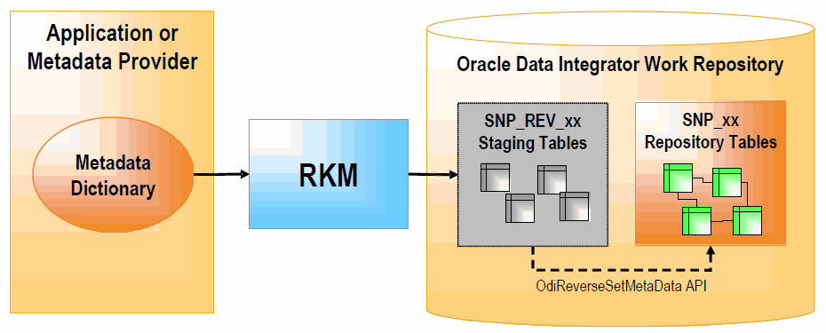

The RKM role is to perform customized reverse engineering for a model. The RKM is in charge of connecting to the application or metadata provider then transforming and writing the resulting metadata into Oracle Data Integrator's repository. The metadata is written temporarily into the SNP_REV_xx tables. The RKM then calls the Oracle Data Integrator API to read from these tables and write to Oracle Data Integrator's metadata tables of the work repository in incremental update mode. This is illustrated below:
Figure 1-1 Reverse-engineering Knowledge Modules
A typical RKM follows these steps:
Cleans up the SNP_REV_xx tables from previous executions using the OdiReverseResetTable tool.
Retrieves sub models, datastores, columns, unique keys, foreign keys, conditions from the metadata provider to SNP_REV_SUB_MODEL, SNP_REV_TABLE, SNP_REV_COL, SNP_REV_KEY, SNP_REV_KEY_COL, SNP_REV_JOIN, SNP_REV_JOIN_COL, SNP_REV_COND tables.
Updates the model in the work repository by calling the OdiReverseSetMetaData tool.

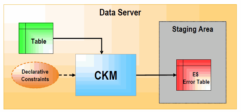

The following figures show how a CKM operates in both STATIC_CONTROL and FLOW_CONTROL modes.
Figure 1-2 Check Knowledge Module (STATIC_CONTROL)
In STATIC_CONTROL mode, the CKM reads the constraints of the table and checks them against the data of the table. Records that don't match the constraints are written to the "E$" error table in the staging area.

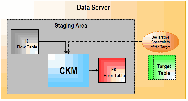

Figure 1-3 Check Knowledge Module (FLOW_CONTROL)
In FLOW_CONTROL mode, the CKM reads the constraints of the target table of the Interface. It checks these constraints against the data contained in the "I$" flow table of the staging area. Records that violate these constraints are written to the "E$" table of the staging area.

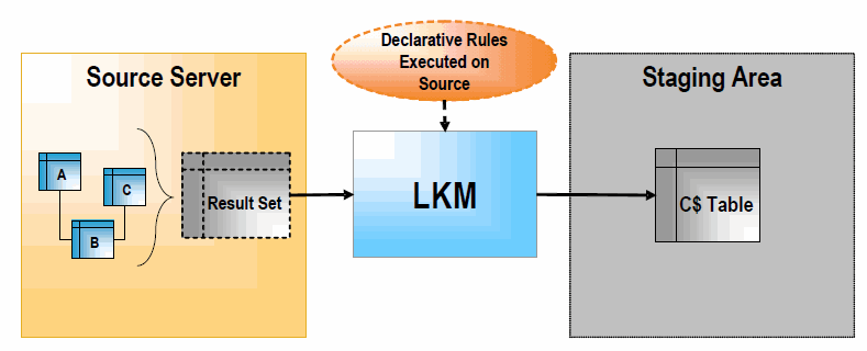

An LKM is in charge of loading source data from a remote server to the staging area. It is used by interfaces when some of the source datastores are not on the same data server as the staging area. The LKM implements the declarative rules that need to be executed on the source server and retrieves a single result set that it stores in a "C$" table in the staging area, as illustrated below.
The LKM creates the "C$" temporary table in the staging area. This table will hold records loaded from the source server.
The LKM obtains a set of pre-transformed records from the source server by executing the appropriate transformations on the source. Usually, this is done by a single SQL SELECT query when the source server is an RDBMS. When the source doesn't have SQL capacities (such as flat files or applications), the LKM simply reads the source data with the appropriate method (read file or execute API).
The LKM loads the records into the "C$" table of the staging area.
An interface may require several LKMs when it uses datastores from different sources. When all source datastores are on the same data server as the staging area, no LKM is required.

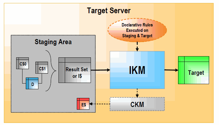

The IKM is in charge of writing the final, transformed data to the target table. Every interface uses a single IKM. When the IKM is started, it assumes that all loading phases for the remote servers have already carried out their tasks. This means that all remote source data sets have been loaded by LKMs into "C$" temporary tables in the staging area, or the source datastores are on the same data server as the staging area. Therefore, the IKM simply needs to execute the "Staging and Target" transformations, joins and filters on the "C$" tables, and tables located on the same data server as the staging area. The resulting set is usually processed by the IKM and written into the "I$" temporary table before loading it to the target. These final transformed records can be written in several ways depending on the IKM selected in your interface. They may be simply appended to the target, or compared for incremental updates or for slowly changing dimensions. There are 2 types of IKMs: those that assume that the staging area is on the same server as the target datastore, and those that can be used when it is not. These are illustrated below:
Figure 1-5 Integration Knowledge Module (Staging Area on Target)
When the staging area is on the target server, the IKM usually follows these steps:
The IKM executes a single set-oriented SELECT statement to carry out staging area and target declarative rules on all "C$" tables and local tables (such as D in the figure). This generates a result set.
Simple "append" IKMs directly write this result set into the target table. More complex IKMs create an "I$" table to store this result set.
If the data flow needs to be checked against target constraints, the IKM calls a CKM to isolate erroneous records and cleanse the "I$" table.
The IKM writes records from the "I$" table to the target following the defined strategy (incremental update, slowly changing dimension, etc.).
The IKM drops the "I$" temporary table.
Optionally, the IKM can call the CKM again to check the consistency of the target datastore.
These types of KMs do not manipulate data outside of the target server. Data processing is set-oriented for maximum efficiency when performing jobs on large volumes.

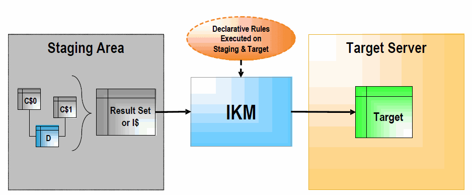

Figure 1-6 Integration Knowledge Module (Staging Area Different from Target)
When the staging area is different from the target server, as shown in Figure 1-6, the IKM usually follows these steps:
The IKM executes a single set-oriented SELECT statement to carry out declarative rules on all "C$" tables and tables located on the staging area (such as D in the figure). This generates a result set.
The IKM loads this result set into the target datastore, following the defined strategy (append or incremental update).
This architecture has certain limitations, such as:
A CKM cannot be used to perform a data integrity audit on the data being processed.
Data needs to be extracted from the staging area before being loaded to the target, which may lead to performance issues.

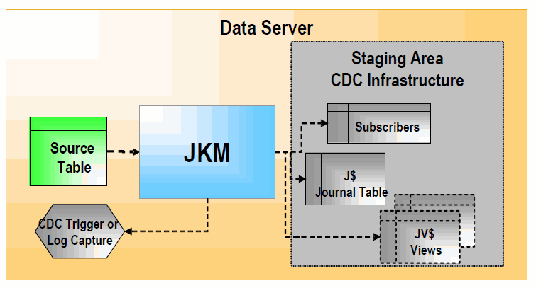

JKMs create the infrastructure for Change Data Capture on a model, a sub model or a datastore. JKMs are not used in interfaces, but rather within a model to define how the CDC infrastructure is initialized. This infrastructure is composed of a subscribers table, a table of changes, views on this table and one or more triggers or log capture programs as illustrated below.
