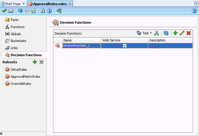

In Rules Designer, select the Decision Functions navigation tab.
In the Decision Functions area, click Create....
Enter the decision function name in the Name field, or use the default name as Figure 6-1 shows.
Figure 6-1 The Decision Functions Area in Rules Designer

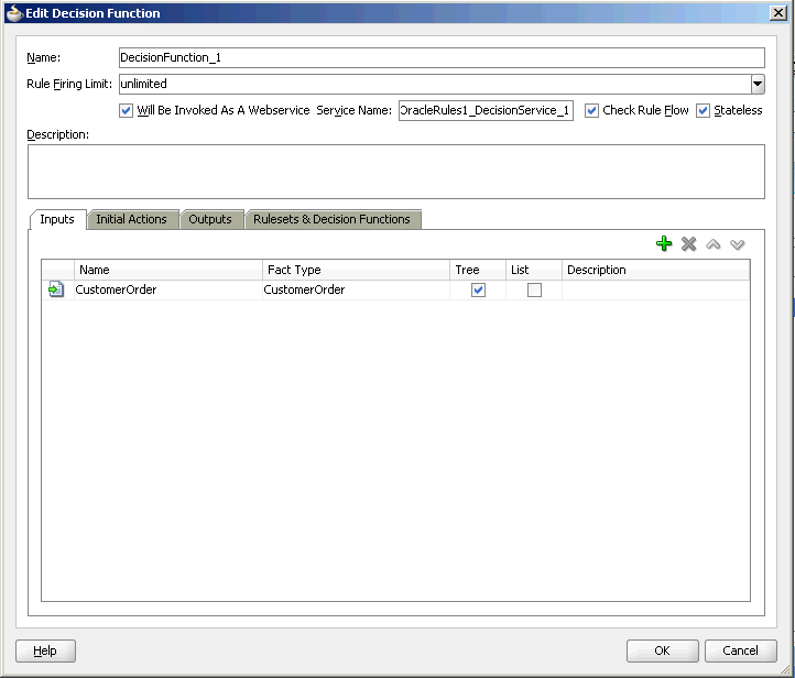

In the decision functions table, double-click the decision function icon. For example, double-click the decision function icon for DecisionFunction_1. This displays the Edit Decision Function dialog, as shown in Figure 6-2.
In the Name field, enter a name or accept the default value.
In the Description field, optionally enter a description.
In the Rule Firing Limit field, select unlimited. In some cases when you are debugging a decision function, you may want to enter a value other than unlimited
for the rule firing limit. For more information, see Section 6.3.1, "What You May Need to Know About Rule Firing Limit Option for Debugging Rules".
Select the appropriate decision function options:
Will be invoked as a Web Service: select whether the decision function will be invoked as a Web Service and provide the Web Service name.
Check Rule Flow: when selected, this option specifies that the rule flow is checked to ensure that facts of the appropriate type are either explicit inputs to the decision function or are asserted by rules in the rule flow. However, when this is selected this does not always produce useful information; there are cases where facts can be asserted in Java code that uses the decision function, but this code might not be available at design time. In this case, validation warnings may produced with Check Rule Flow selected may not be useful.
Stateless: when selected specifies the decision function is stateless. For more information, see Section 6.3.3, "What You May Need to Know About the Decision Function Stateless Option".
In the Inputs tab, click Add to add inputs. For each input in the Inputs Table, select the appropriate options:
Name - enter an input name and press Enter or accept the default name.
Fact Type - select the appropriate fact type from the list.
Tree - When unselected, the input is asserted using the assert
function. When selected, the input is asserted using the assertTree
function. When selected it is expected that the input object or objects are the root of an object tree that is connected in one-to-many relationships with other objects using List
properties. For more information, see Section 4.8, "Working with Tree Mode Rules".
List - When unselected, the input must be a single object and the assertion applies only to that single input object. When selected, the input must be a List
of objects and the assertion applies to each object in the input List
(java.util.List
Description - Description of the input.
In the Outputs tab, click Add to add outputs. For each output in the Outputs Table, select the appropriate options:
Name - enter an output name and press Enter or accept the default name.
Tree - When selected, this option sets a flag that enables certain design-time decision function argument checking. For an output argument, this option has no effect on runtime behavior. However, at design time in the case where several decision functions are called in a sequence, it is useful to notate explicitly that the output of one decision function is a tree. This implies that the input of another decision function in the sequence is expecting a tree as an input. For more information, see Section 4.8, "Working with Tree Mode Rules".
List - When unselected the output is a single object. When selected the output is a group of objects. For more information on the behavior of the List option on an output argument, see Section 6.3.2, "What You May Need to Know to About Decision Function Arguments".
Description - Description of the output.

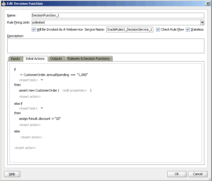

In the Initial Actions tab, you can add actions that could be used to change input facts before they are asserted, change the ruleset stack, set the effective date, or even assert output facts. These actions could be used instead of rules, or to "set up" the environment for running rules.
Consider a situation where a decision function (DF1) calls another decision function (DF2) using the Initial Actions tab. DF1 is configured to push Ruleset1 to the ruleset stack. DF2 is configured to push Ruleset2. In DF1, before the initial actions are executed, Ruleset1 is pushed to the ruleset stack. Then, when DF2 is called, Ruleset2 is also pushed. So when rules start running, rules from both rulesets fire because of the ruleset stack. If you want to push Ruleset2 (because in the initial actions, you are calling DF2), you can use initial actions in DF1 to clear the ruleset stack before calling DF2, and push Ruleset1 on the stack after calling DF2.
You can add any required action ranging from assert
, call
, modify
to even conditional actions such as if
, else
, elseif
, while
, for
, if
(advanced)
, and while
(advanced)
as shown in Figure 6-3.
If decision function DF1 contains DF2 in the Rulesets & Decision Functions tab, then DF2 may not have any initial actions.
The if
(advanced)
and while
(advanced)
conditional actions accept only boolean
values. For each of the action conditions, you can add different test form types.
