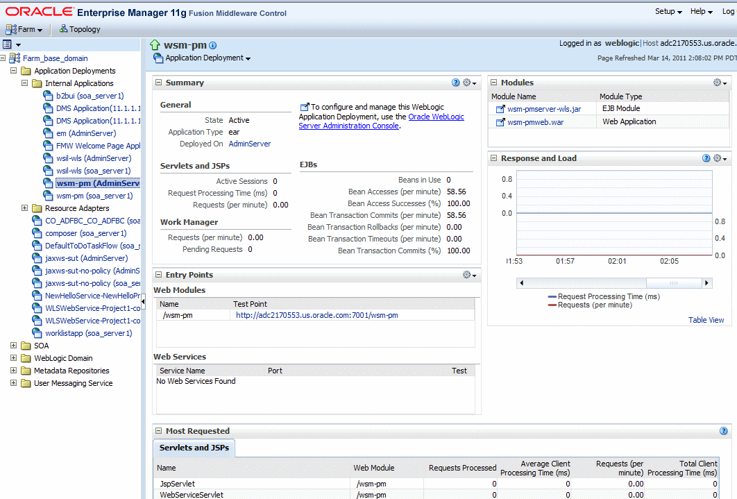

To view the Oracle WSM Policy Manager page:
  1. In the Navigator pane, expand Application Deployments.
  2. Under Application Deployments, expand Internal Applications.
  3. Select wsm-pm.
    The Oracle WSM Policy Manager home page is displayed.
    Figure 16-1 Oracle WSM Policy Manager Page
    Description of Figure 16-1 follows
    Description of "Figure 16-1 Oracle WSM Policy Manager Page"
  4. From the Policy Manager page, you can perform one or more of the following tasks:
    • In the General area of the page, you can check the current state of the Policy Manager and identify the server to which it is deployed.
    • In the Response and Load section of the page, you can view the response time and current load. To view this information in tabular form, click Table View.
    • In the Entry Points section of the page, you can validate the connection to the Policy Manager. To do so, in the Web Modules table, click the Test Point URL for wsm-pm. On the Validate Policy Manager page, click the Validate Policy Manager link, as shown in Figure 16-2.

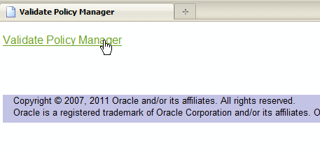

    You can also access the Validator page in a Web browser using the following URL:
    http://host:port/wsm-pm/validator
    In this URL, host and port represent the host and port number on which the Policy Manager is running.
    If the connection to the Policy Manager fails, an error message is displayed. If the connection to the Policy Manager is successful, the Policy Manager Validator page displays the following information:

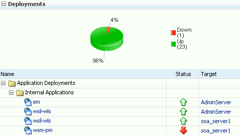

  • The Policy Manager is down. You can determine if the Policy Manager is down as follows:

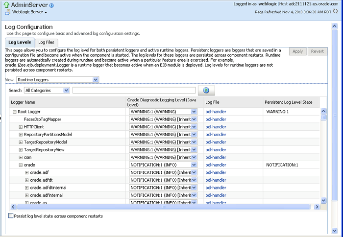

  2. From the WebLogic Sever menu, select Logs > Log Configuration.
    The Log Configuration page is displayed.
  3. Select the Log Levels tab.
    The list of loggers is displayed, as shown in Figure 16-6.
    The Log Levels page shows the name of the logger, the current logging level, which you can edit, and the associated log file (for example, olh-handler). For information about configuring the log files, see "Configuring Log Files for a Web Service".
    Figure 16-6 Log Levels Page
    Description of Figure 16-6 follows
    Description of "Figure 16-6 Log Levels Page"
  4. Expand Root Logger.
  5. Expand oracle.
  6. Set the logging level for one or more of the following components:
    • oracle.webservices—Web service components.
    • oracle.wsm—Oracle WSM components.
    You can fine tune the logging level by expanding either of the above components and specifying the logging level at the subcomponent level.
    To change the logging level for a logger, navigate to the logger in the Logger Name column and select the desired logging level from the Oracle Diagnostic Logging Level (Java Level) drop-down menu.
    For example, select TRACE:32 from the drop-down menu associated with the oracle.wsm logger.
    By default, the logging levels are inherited from the parent and set to NOTIFICATION: 1 (INFO) for the Web service and Oracle WSM components and subcomponents.
  7. Click Apply to store the new logging level.

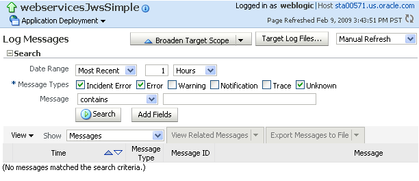

You can view a summary of all faults incurred by the Web services in your application. For more information, see "Monitoring the Performance of Web Services".
The Log Messages page is displayed, as shown in the following figure.
Figure 16-7 Log Messages Page
Description of Figure 16-7 follows
Description of "Figure 16-7 Log Messages Page"
Click on a message in the message area to view more details at the bottom of the page. If desired, you can export a message to a text, XML, or CSV file by selecting the messages on the list and clicking Export Messages to File.
You can control the message content displayed using the following controls:
  • Search—Modify the search criteria. For more information, see "Filtering Diagnostic Logs".
  • View menu—Select the columns to display in the table. Click on a particular column to sort contents up or down.
  • Show menu—Group messages by type or ID, or view them in chronological order.
  • View Related Messages—View messages related to those selected on the list.
  • Broaden Target Scope—Broaden the scope of messages displayed. You can broaden the scope to include all messages for the domain, WebLogic Server, or Farm.
  • Refresh menu—Specify an automatic or manual refresh rate.
To view the contents of a generated log file:
  • Click the log file icon associated with a message to view the contents of that log file.
  • Click Target Log Files... to display the Log Files page and view or download the contents of all generated log files.
For more information, see "Viewing and Searching Log Files" in Oracle Fusion Middleware Administrator's Guide.

Viewing Message Logs
You can view the message log files for an ADF and WebCenter Web service endpoint from the Log Messages page.
To view message logs for a Web service endpoint:
Navigate to the Web Service Endpoint page, as described in "Viewing the Details for a Web Service Endpoint", and in the Quick Links section of the Web Services Endpoint page (top right), click Message Logs.
The Log Messages page is displayed, similar to Figure 16-7. For more details about the contents of the Log Messages page, see "Viewing Diagnostic Logs".
Filtering Message Logs
By default, the Log Messages page displays a summary of SOAP messages logged over the last hour. You can filter the messages that are displayed by updating the search criteria. The process is the same as for diagnostic logs; for more information, see "Filtering Diagnostic Logs".
By default, the Component and Module message fields are included as part of the Search criteria for message logs. The Component field is set to the WebLogic Server name; the Module field is set to oracle.wsm.msg.logging, which is the name of the message logging component.

The following procedure describes how to set the log level for diagnostic logs at the WebLogic Server and Web service endpoint levels.
For more information about using Fusion Middleware Control or WLST to set the log levels, see "Setting the Level of Information Written to Log Files" in Oracle Fusion Middleware Administrator's Guide.
To configure the log files for a Web service:
  1. Navigate to the WebLogic Server for which you want to configure a logger.
    1. In the navigator pane, expand WebLogic Domain.
    2. Expand the domain.
    3. Select the desired server from the list.
      The WebLogic Server home page is displayed.
  3. Select the Log Files tab.
    The current list of log files is displayed, as shown in Figure 16-8. The Log Configuration page shows the currently configured log path, file format, and rotation policy.

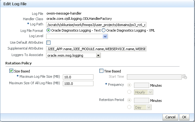

  4. If you wish to edit the log policy configuration, select the log file in the list and click Edit Configuration . . ..
    The Edit Log File page is displayed.
    Figure 16-9 Edit Log File Page
    Description of Figure 16-9 follows
    Description of "Figure 16-9 Edit Log File Page"
  5. Edit the log file information, as required.
    Table 16-3 Fields in Edit Log File Page
    Field Description
    Log Path
    Path to the log file. This field is required.
    Log File Format
    Format of the log file. Valid values are text or XML.
    Log Level
    Default log level for the logger. Select a log level from the list. Valid values include:
    • INCIDENT_ERROR:1 (SEVERE+100)
    • ERROR:1 (SEVERE)
    • WARNING:1 (WARNING)
    • NOTIFICATION:1 (INFO)
    • NOTIFICATION:16 (CONFIG)
    • TRACE:1 (FINE)
    • TRACE:16 (FINER)
    • TRACE:32 (FINEST)
    Use Default Attributes
    Flag that specifies whether to use default attributes for the logger.
    Supplemental Attributes
    Supplemental attributes required.
    Loggers to Associate
    Components to associate with the logger.
    Rotation Policy
    Specify whether you wish to rotate log files based on file size of length of time. For more information, see "Configuring Log File Rotation" in Oracle Fusion Middleware Administrator's Guide.
    If Size Based is selected as the rotational policy, Maximum Log Files Size is a required field. If Time Based is selected as the rotational policy, Frequency is a required field.
  6. Click OK to edit the log file configuration.
