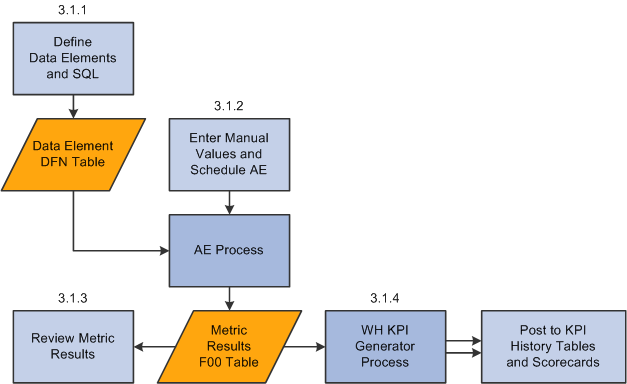

The following diagram illustrates the data flow from Customer Scorecard through the PeopleSoft Customer Relationship Management Data Mart, with final results accessed through the reporting solution:
Data flow from KPI detail to the PeopleSoft Customer Relationship Management Data Mart
