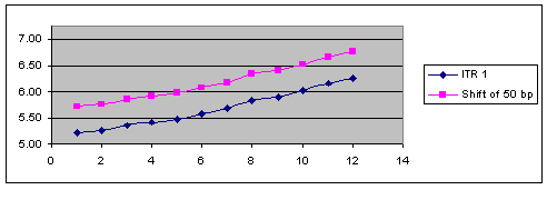

The following illustration represents these concepts. Here, the price index is evaluated against key underlying values in a smooth function. The unadjusted target value is evaluated against the key underlying rate for reasonableness. This test can be defined as a spread against the key underlying. This test ensures that the unadjusted target value never falls out of this reasonableness range, regardless of the absolute level of interest rates.
Price index concepts illustrated
The red line (adj. target value) is the most important to follow. This represents the price index after adjustments; it remains within a defined spread range from the key underlying value (for this example, they are set at +400 and +200 bp). In this case, the adjusted target value is the price index because the value remains within the defined constraints. The blue line represents the unadjusted target value before evaluation against the constraints. In the periods where there is no blue line visible, the red line and the blue line are equal and there is no constraint violation. Where the blue line is visible, it exceeds the constraints and therefore cannot be the price index. The gray line is the original key underlying value that does not have any constraints.

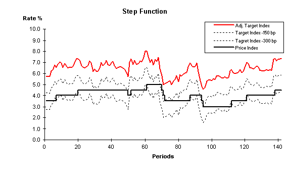

The Index Adjustment page enables you to assign a step function to the adjusted target index. Select Smooth if you want a price index that continuously moves in response to the movement of the target index. Select Step (for step function) if you want the price index to move only when the spread between the price index and the target index is in excess of a specific threshold for a defined period.
Movement of the step function is defined by the criteria in a range that you specify that affects a change in the price index value. The step function range is defined as a minimum and maximum spread relative to the adjusted target index. As long as the price index value stays within this range, it does not change. If the price index drifts below or above the range (for a consecutive period of time that is also defined by the user) it is adjusted upward or downward. The level of adjustment may be defined to be an absolute move or a percentage of the difference between the current rate and the target index. The following graph illustrates this concept:

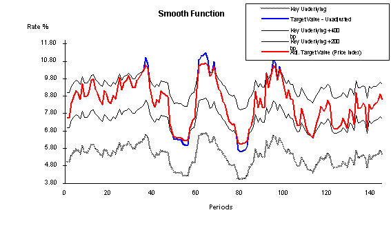

Smooth and step functions
The solid, red line represents the price index (adjusted target index) that you define in the Price Index page after it is evaluated against the key underlying rate that is defined in the Index Adjustment setup page. The dotted lines represent the range that you define as the allowable spread between the adjusted target index and the current index value (product rate). The solid, angular line is the way that the adjusted price index responds to the step range and adjusted target index.
The Index Adjustment page enables you to define the parameters that are evaluated against the target index for a reasonableness test.

Adjusting the Pricing Index
Access the Index Adjustment page (Financial Services Industries, Interest Rate Environment, Dataset Definition, Pricing Index, Index Adjustment).
On the Index Adjustment page, specify the type of key underlying value that you want the target index evaluated against by specifying a key rate type. Options are Yield Curve or Index.
If you select Yield Curve, specify the corresponding yield curve code and maturity.
If you select Index, specify the corresponding index ID.
Then, enter values in basis points for the upper and lower boundaries of the target index spread in the maximum and minimum spread fields. Enter values in percentage points for the maximum and minimum rates of the target index over its entire life in the absolute maximum and minimum fields. When you are finished, set up the Step Functions page.
Defining the Pricing Index Step Functions
Access the Step Function page (Financial Services Industries, Interest Rate Environment, Dataset Definition, Pricing Index, Step Function).
Set up the Step Functions page for both equation and yield-curve defined target indexes. Specify the upper and lower boundaries of the spread threshold in basis points. Do this in the Index <> Adj. Key Rt +- (bp) fields. Use the decrease column for upper boundaries and the increase column for lower boundaries. Values may be positive or negative.
In the For Consecutive Periods fields, specify the interval of consecutive periods for which the threshold test must be true to initiate a change in the price index (for both upper and lower boundaries).
In the Adjustment Method fields, indicate the manner in which the step function adjusts to fluctuations in interest rates and periods. Select Delta for an absolute change or % of Difference for a relative change in the price index if the threshold test and the interval test are true.
In the Delta fields, specify the rate change rule that is applied to the price index in a declining (Downward Delta) or rising (Upward Delta) environment.

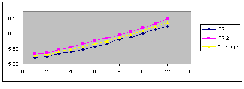

Average returns the average value between two values. For example, following is a plot of internal transfer rate 1 and internal transfer rate 2, with the average of the two data sets making up the third plot as the average of the two data sets:
AVG

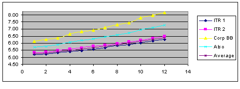

Also adds a new source to an already calculated operation and repeats this calculation with the result of the previously calculated result and the new source. Also is most likely used in conjunction with the AVG operation code to average an additional data source with the previously averaged values.
For example, the ITR 1 curve and the ITR 2 curve are averaged by using the AVG operation code. In addition, you want to calculate the average between this newly calculated average (comprised of the averaged data set ITR 1 and ITR 2) and the Corp BB curves. This is done by using the ALSO operation code. The following graph illustrates the ALSO operation code:
(ITR 1 + ITR 2) /2 = Average value (Average + Corp BB) /2 = Also value
ALSO
Note. Average represents the average between ITR 1 and ITR 2. Also represents the average between average and Corp BB.

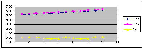

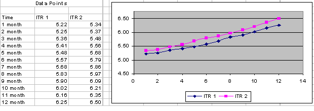

This operation code calculates the absolute difference between two yields. DIFF subtracts the lower from the higher value and displays the new value. No negative values can result from this operation. The following graph illustrates the DIFF operation code.
DIFF

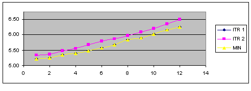

MIN calculates the absolute minimum value from two sources. This operation code compares two data sets and selects the lowest representative data point between the two data sets. The following graph illustrates the MIN operation code.
MIN

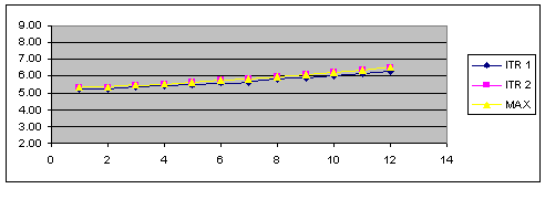

MAX calculates the absolute maximum value from two sources. This operation code compares two data sets and selects the greatest representative data point between the two data sets. The following graph illustrates the MAX operation code.
MAX

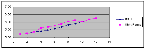

The SHIFT operation code allows the user to apply a basis point shift to an existing data set. The basis point shift is applied to the entire data set. The following graph illustrates the SHIFT operation code.
SHIFT
SHIFT RANGE allows the user to apply a basis point shift to an existing data set that is within a specified time frame. The time frame is specified with a start maturity and an end maturity, which are defined in days, months, or years rather than as actual dates. The following graph illustrates the SHIFT RANGE operation code.
SHIFT RANGE

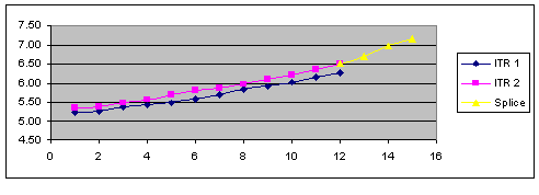

Splice divides an existing curve into a new curve with two or more data sources or types of interpolants.
Note. A curve's interpolant can be spliced only if Global Interpolant is not selected.
The following graph illustrates the SPLICE operation code.
SPLICE

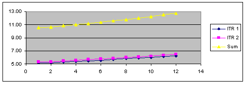

The SUM operation code adds the data points of two data sets and creates a third data set with the totals. The following graph illustrates the SUM operation code.
SUM

Shift Type |
Parallel is the default value. Select Shape to assign various shifts to individual tenors on the yield curve. You can insert rows to use multiple Data Set codes and a mix of both parallel or shape shifts for the respective Data Set codes that are selected. You cannot select the same Data Set code for both an application of a parallel or shape shift type. |
Tenors |
Click this button to access a separate page to set up tenors. |
Delta (bp) basis point |
Indicate the change in basis points that is allotted to the entire curve when the shock model is a parallel move. |
Interpolation |
Options are Step or Linear. |
Setting Up the Shock Model
To access this page, ensure that the model is defined as a shock model in the Model Definition page and then click the Tenors button.
You supply the change to the rate in basis points next to the designated tenor shift. As you supply the Delta (bps) (delta basis points) values, the instantaneous yield curve shift scenario that is plotted in green is charted alongside the base scenario plot. You have the flexibility of designating shaped shift types (besides a parallel shift) across all tenors. Click the Reset button to reset the curve shift scenario plot and data points. Click OK to accept the changes to the shock model.
