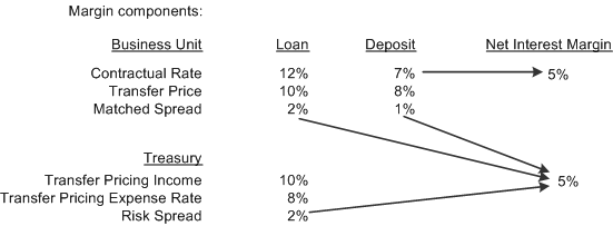

To illustrate, assume that the bank has issued a short-term time deposit costing 7% and funded a long term loan yielding 12%. The deposit costs 100 basis points (bps) less than purchased funds with a similar maturity, and the loan has a yield 200 bps higher than the bank would pay for funds of the same maturity. This graphic illustrates the margin components:
Funds Transfer Pricing Margin Components
The end result is that the spreads reported on assets and liabilities are more stable, reflecting the true economic contributions of these products, while the income variability resulting from changing interest rates is isolated in the treasury, where it can be best managed on a consolidated basis.
