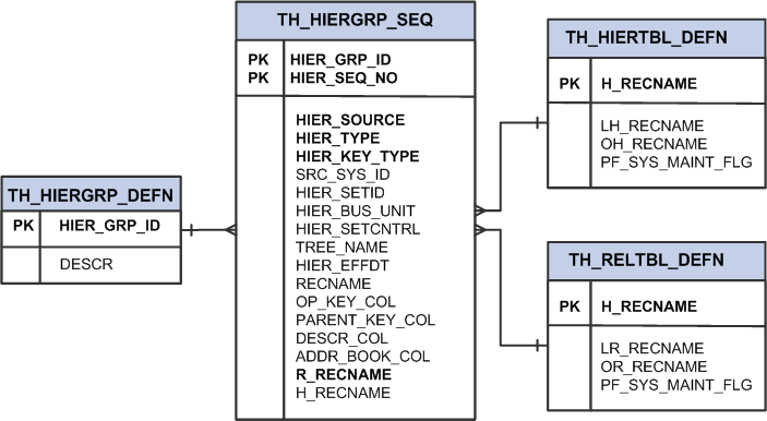

The balancing process requires up to two parameters on the Hierarchy Group Definition:
The flag to indicate that up-balancing, down-balancing, or no balancing process is to be performed.
The special character to indicate that a node is introduced as a result of the balancing process.
If no balancing is required, you do not populate this field.

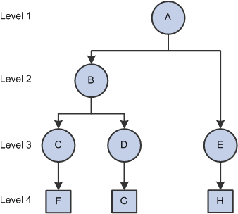

Skip Levels
Trees with strictly enforced levels require that each path of the tree has the same depth. You can skip a level if a portion of the hierarchy does not have nodes at that level. For example, one path in a tree may have levels A, B, C, and D, and another path may have levels A, C, and D (skipping level B).
Similar to tree balancing, skip level handling produces synthetic, or artificial, node entries to fill the gap in a denormalized table. For some business intelligence tools, especially ROLAP tools, you must close the gap produced by a skipped level to use the denormalized table effectively.
Because not all business intelligence tools require a skipped level to be closed, skipped level handling is optional. You use the same flag that indicates up-balancing or down-balancing for tree balancing to indicate processing of skip levels. The special mark for nodes that result from skip level processing is applied to the description field. The special mark is <dds>, where <dd> is the two-digit level number and <s> is the special character that you enter in the Skip Level Infix field on the Hierarchy Group Definition page.
Note. The special mark templates that you use for skip level balancing and for regular balancing can be the same or different than the other. For example, you can use <ddb> to refer to the result of balancing and <dds> to refer to the result of resolving a skip level, where dd refers to the level number, such as 03, b refers to the balancing infix character, such as ~, and s refers to the skip level infix character, such as #.
Skipping Levels Example
To provide an example of the skip-level process, consider the following summer tree:
Skip level summer tree
The following table represents the tree flattener result:

Tree Flattener and Denormalizer Results
The output of flattening and denormalizing trees depends on the type of tree: summer or winter, balanced or unbalanced, skip level, and so on.
Summer Tree
This graphic shows an example of a summer tree before processing and without any balancing:
Example of a summer tree before processing
Processing of this tree results in the following relationship table:

Winter Tree
This graphic shows an example of a winter tree before processing:
Example of a winter tree before processing

Setting Up Parameters for Tree and Recursive Hierarchy Processing
Before you can run the actual Tree and Recursive Hierarchy ETL process, you must first define the parameters for process.
This section provides an overview of parameters for the Tree and Recursive Hierarchy process and discusses how to:
Define the target and language tables for tree flattening.
Define the target and language tables for tree denormalizing.
Create the hierarchy group definition.
Defining Parameters for the Tree and Recursive Hierarchy Process To run the Tree and Recursive Hierarchy process, use the Tree Hierarchy-Relational Table (TH_RELTBL_DEFN) component, Tree Hierarchy-Hierarchy Table (TH_HIERTBL_DEFN) component, and Tree Hierarchy-Hierarchy Group Definition (TH_HIERGRP_DEFN) component.
Because you must first flatten all hierarchies that are processed, you must define the relationship table that is the target for the flattening process. Because the denormalization process is optional, you must define the hierarchy table only if you intend to denormalize the flattened table.
The following diagram shows the Tree and Recursive Hierarchy processing setup pages:
Tree and recursive hierarchy processing setup pages
Pages Used to Run the Tree and Recursive Hierarchy Process|
Page Name |
Definition Name |
Navigation |
Usage |
TH_RELTBL_DEFN |
EPM Foundation, EPM Setup, Common Definitions, Hierarchy Group Definition, Relationship Table Definition |
Define the target and language tables for tree flattening. |
TH_HIERTBL_DEFN |
EPM Foundation, EPM Setup, Common Definitions, Hierarchy Group Definition, Hierarchy Table Definition |
Define the target and language tables for tree and hierarchy denormalizing. |
TH_HIERGRP_DEFN |
EPM Foundation, EPM Setup, Common Definitions, Hierarchy Group Definition, Hierarchy Group Definition |
Enter parameters for the Tree and Recursive Hierarchy process. |
