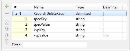

  6. In the upper pane of the Metadata Editor:
    1. Click the Record:recordName1 Name field and change the recordName1 default value to a name such as DeleteRecs.
    2. Make sure that the Type field of all properties is set to type string. For example if the specKey property is set to integer, change it to string.
    3. Verify that all properties have the correct delimiter character set (which is the pipe character in our example). At this point, the pane should look like this example:
    4. When you have input all your changes, click Finish.
